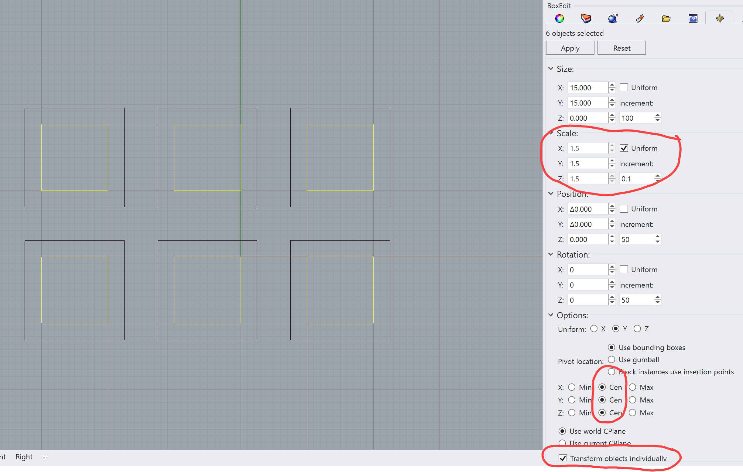

Are you looking to do this in Rhino or Grasshopper? If the latter, please tag your post accordingly.
If you want to do this in Rhino, select the objects, then use BoxEdit with Transform objects individually ticked:
HTH
Jeremy
Are you wanting to scale the rectangles? If so you need to connect the curves to the scale component “G” input. Right now you are scaling the points, which doesn’t make sense…
