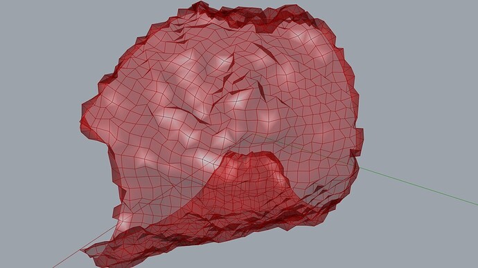

Incredible how you already answered a future problem of mine in your first response… After the inflation (form finding), I am now trying to deflate and fold the shape agaiin.
I tried to fix it by following your steps mentioned above:
  • extended the initial quad-mesh (dont know how achieve this in a simple way with the triangulated mesh)
  • extracted the point pairs and applied the Transform Force with the mirror transformation with the corresponding plane
  • applied smoothing onto the extended mesh
results are looking much better now, however I am not sure if this is 100% correct, as the transform force and the smoothing seem to stabilize the mirrored edge a bit and thus resulting in small hills at the border…
in order to prevent self intersections during deflation, I am also using the Sphere Collide component. Setting the shortest edge length of the mesh as the sphere diameter works, but the spheres become too small:
So I thought, looking for the shortest connected edge to each individual vertex and taking it as the diameter for each respective sphere would make more sense.
It looks as if it should work, however running the simulation with those individual diameters slows Kangaroo down a lot and does not yield any results, as the Sphere Collider seems to create lots of self intersections…
Any ideas why this is the case?
deflation.gh (187.2 KB)
@DanielPiker I tried to narrow down the problem:
There seems to be an issue when a list of radii is connected to the sphere collision component.
This is the first approach using different radii - one would mean that this should work perfectly.
However this is the simulatino result:
Assuming that the issue lies with the radii list, i created the average of the radii list (=single value):
and ran the simulatin again:
Although there are now a lot of sphere collisions, which did not exist before - the results looks much better and exactly as it should.
Furthermore, attaching a list of radii a slows down Kangaroo immensely, going from around 30-50ms per iteratino to more than a second.
Is there some bug here, or are adaptive radii just not supported?
sc_problem.gh (105.9 KB)
Thanks a lot,
Rudi
Hi Rudi,
Thanks for narrowing it down - I did open your earlier definition, but there was a lot to look through.
Here the issue is that SphereCollide uses all the same radius - so by giving it multiple radii, you were actually duplicating the entire set of collisions for every value.
The Goal which does support different radii is Collider
Beautiful, will try it out immediately!
