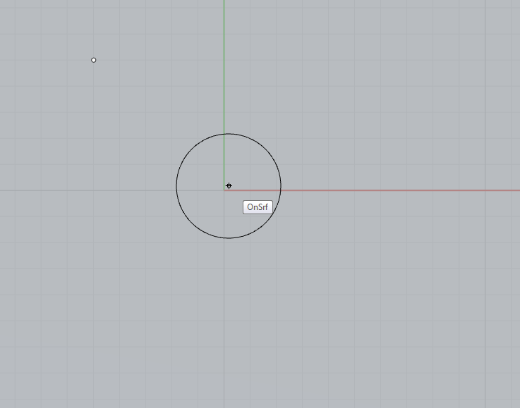

Let’s say I want to create a hole through whatever object, along the Z-axis, center of the hole on the centerpoint.
Wouldn’t it be great if the mouse could either snap the centerpoint or any point on my grid?
I tried all kinds of things but so far can’t see a way without additional geometry like a point which I have to place on 0/0/0, a curve where I can pick the end or I place the hole anywhere and move it to the centerpoint after it has been created.
The Center osnap will find the center of a circle like you describe, but you have to place your pointer over the circular part to find the center, not where the center actually is.
Osnaps override grid snap so you can do what you described.
But yeah, grid snapping does not work, nor any direct point input… I see that, and I don’t know if it can in this case. I’d think it would be hard but the smart track working seems to indicate it’s possible… I’ll ask.
I see that you can get grid snapping to work indirectly as well - for example with the Between Osnap you can snap to the grid inside RoundHole, so, yeah, I bet this can be made to work.

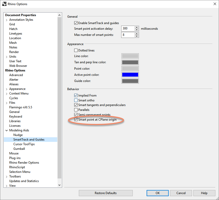

Oh, I didn’t know about the smart point setting. Does the job for now.
And then I just realized Smart Track and Grid Snap both switched on is helpful.
