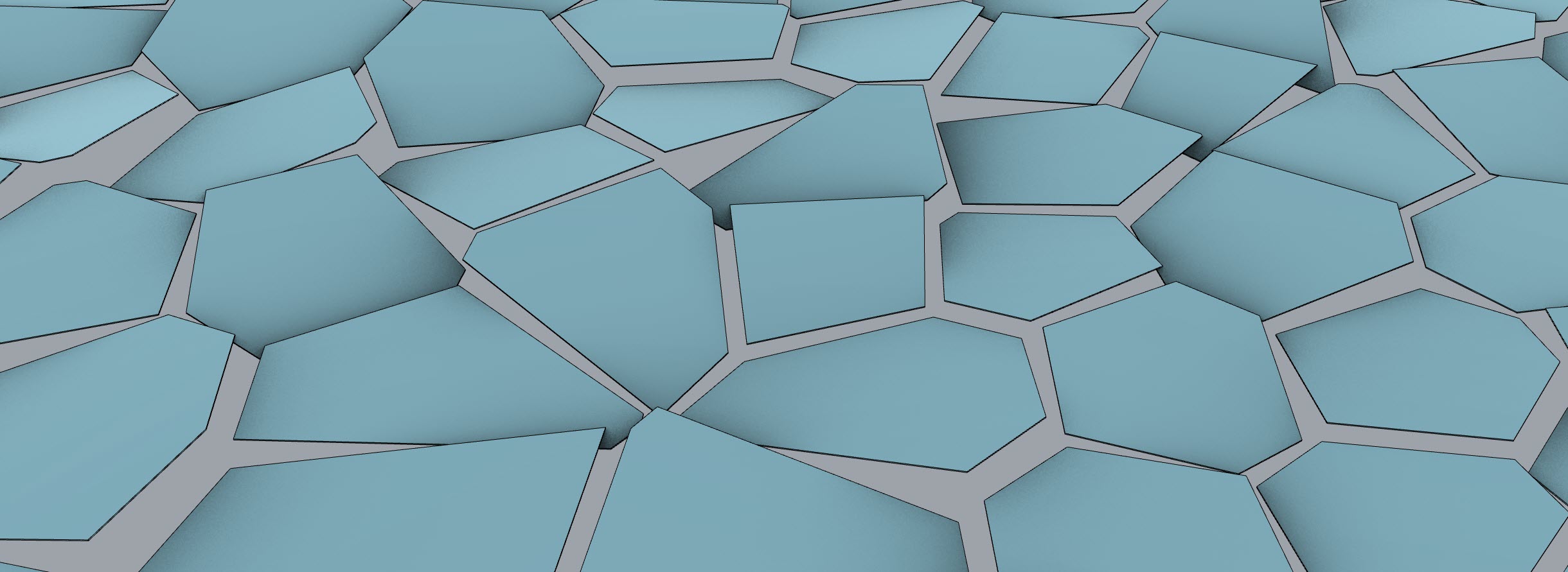

Hello.
I created a small definition. As a result, many surfaces are created.
Now handmade.
I divided all surfaces into eight groups. Each surface inside their groups I turned to 3 degrees оn the side views.
Please help me to do it automatically inside the grasshopper.
Thanks.

Hi @leex ,
I don’t have clipper but you should be able to plug your offset polylines into the E input of the “Surfaces To Rotate” node in this definition and get the result you are looking for.
The 2nd and 3rd function aren’t needed, they are just for visualization purposes.
Let me know if you have any questions!

Hi @leex ,
By chaos do you mean randomized rotation and in multiple axis?
Yes, that’s just what I mean.
Randomized rotation in two coordinate axes.
Welcome to the chaos:
I created a python component that will allow you to randomly rotate within a specified range and takes a mask input allowing you to choose which inputs you want to rotate within.

@leex ,
Here you are:
Graph Space:
Model Space (Random rotation in XYZ min 0, max 3 degrees):
20230820_Rotate multiple surfaces_Response_01b.gh (21.3 KB)

Michael, now I tested on the same circles and noticed that the turns have a different angle.
The circles that I designated blue turned a little bit.
It’s embarrassed to ask, but I would like you to see what is wrong here.

@leex ,
Don’t be embarrassed haha! I’ll see what I can see, one moment
Looks good on my end?
When you say turned a little bit do you mean when you re-ran the script they moved again, and you had values that you “liked” and then they moved? If so that’s because each time the script runs its random so if you want it to maintain the last randomness iteration we need to add a seed value to the randomness (not a problem to do but wanting to know if that’s what you meant?)
OR
Did you mean that the blue ones moved “only a little bit” as in barely rotated much in comparison to the others and you would like better control over the range to ensure that a near 0 rotation is not possible?
Because currently if your range is -15 To 15 a rotation of 0 or 0.1 or even 0.00001 is possible as it’s within that range
Yes, I mean that the blue ones moved “only a little bit”.
I would like each element to be turned on the same angel. But randomly in any side (on the Front or Left view).
Rotate Circle
I would like to strictly set the angle of inclination of all elements.
Rotate Circles
Hi @leex ,
If I understand you correctly…
That’s what the XY mask would do, provided you have consistent input planes.
Graph Space:
Model Space:
Note the consistent world aligned planes:
If you don’t want to evaluate the surface or in the case of your earlier voronoi example, simply using the area component and plugging the C “Center” output into the Rotation Script P input should give you a rotation center that is World XY aligned by default.
What that looks like in Graph Space:
And Model Space:
