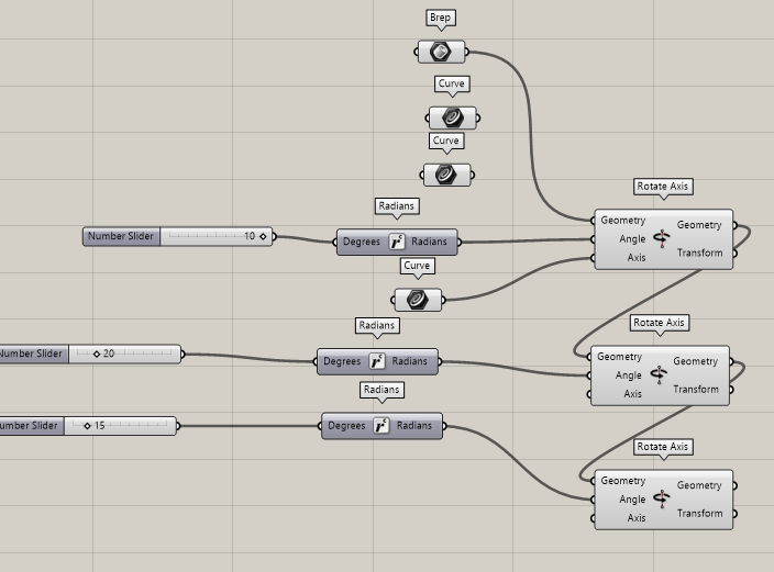

I’m trying to take an object and rotate it & translate it based on real world measurements I have taken this past week and stored in a CSV file. I have everything working except my rotation…
I need to rotate about the Y axis, then the Z axis, then the X axis. These are independent axes of rotation, not like a gumball. Rotating about the Y axis is very straight forward, however, I need the Z and X axes to rotate about the Y axis with the object. Then I need to rotate the object and the X axis about the Z axis. Then finally rotate the object alone about the Z axis.
The Rotate axis command only accepts 1 input for geometry - is there anyway to group geometry together prior to rotation?

It’s not very clear to me what you want to do?
Your second and third Rotate Axis components appear to be using the same axis, a line in the X direction from the origin?

P.S. Version ‘B’ uses your three axes and rotates them as a group, per your description?
Rotation_2021_Jun27b.gh (14.3 KB)
Thank you. Version B is exactly what I needed! I was trying to group previously, but did not know about the ‘merge’ function.
