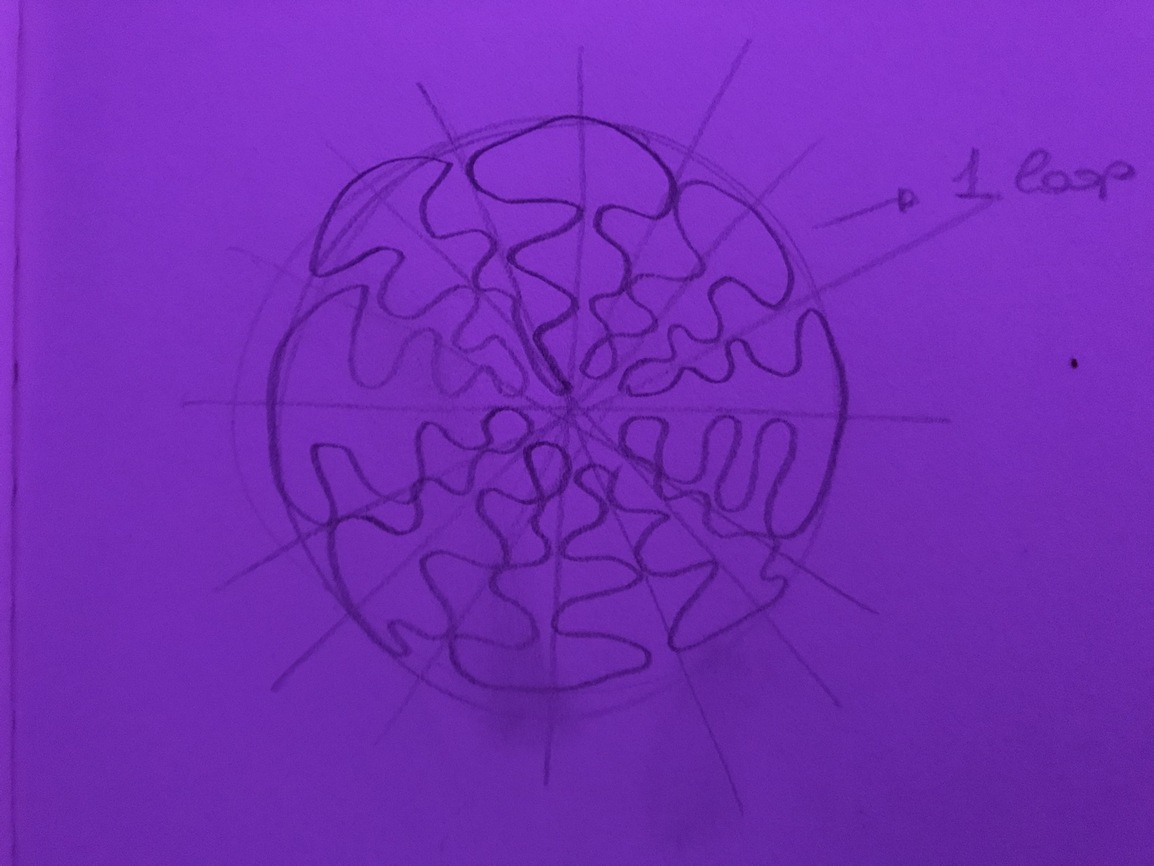

I would like to create a rose pattern characterised by one curve. I started from a circle and draw its radius. These are the “binary” of my weave pattern. After I divide each radius in segment and using the cull pattern component I take the points alternatively. Now I would like connect all of them using a polyline (that later can be fillet or using interpolate) to create a weave pattern composed by one curve (as the images)
Do you know how can I organise the data list in order to achieve that?
