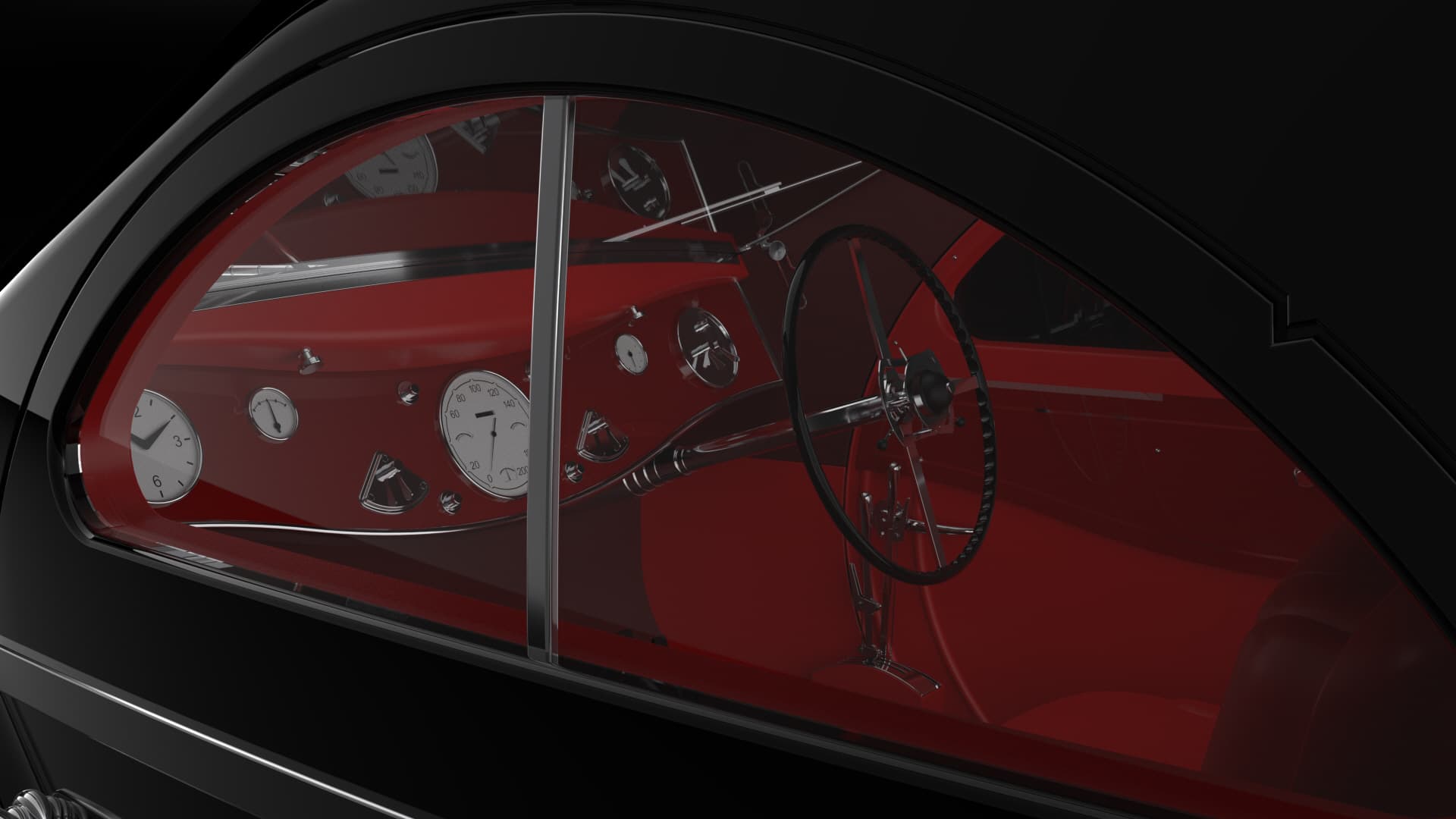

Built in 1925 as Phantom 1, the vehicle was given a new body in 1935 by Jongheere / Belgium. The vehicle is considered to be one of the most beautiful coupes ever built.
Unfortunately, there are no particularly good drawings of the car on the Internet - some have windows that do not even exist on the original - so the replica will not necessarily correspond 100% to the original - it doesn’t matter - I like it. All parts except the fenders and Emily were made as nurbs. So - and one more small note - you should revise the rounding function thoroughly - it often makes your hair stand on end.
Have fun looking at it.
Regards
Rainer!

May you show its shaded view?

A few questions
1- How do you obtained its accurate characteristics (dimensions …etc)?
2- Which methods did you use in Rhino to design the parts (the stages of your works)?
3- Are those parts integrated, or separate, and you assemble them later?
Hi there,
So - you can’t get the exact dimensions anywhere - you can’t measure the vehicle - but - there are some providers on the Internet, e.g. Blueprint.com, where you can buy more or less good drawings - I use the Google image search to download the reduced images of it - I load it into Rhino and scale it up - then you have top view, sides, front and rear view - but they often don’t go together - unfortunately … For the details I look for photos and design the parts accordingly.
The Rolls is created on the main part of the bodywork - bonnet, passenger compartment and rear by means of a guide line and cross-section - the fenders are constructed with SubD - the wheel arches are then cut out with curves from the surfaces that have been converted into nurbs - this is easier, faster and cleaner than then Modeling the wheel arch in SubD - after more than 30 years on the Cad, I try to keep constructions as simple as possible for myself - that’s why (to 3.) I separate constructions into individual parts if possible, which I then connect - I work with Rhino now for about 5 months (I bought privately for my own designs) and I am constantly discovering new things that I can do with it - hehe.
Regards
Rainer
