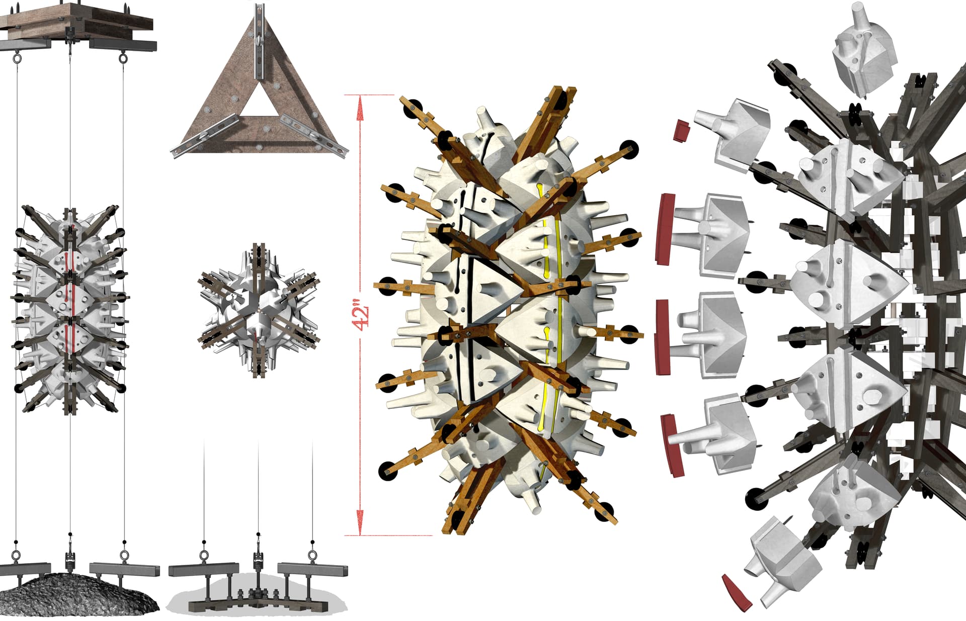

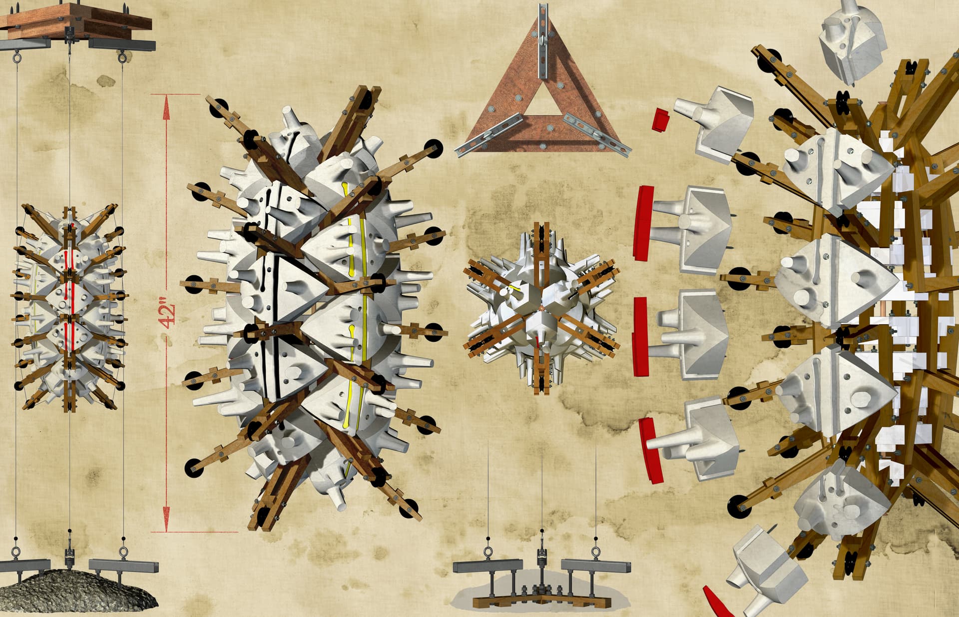

But I never did. I had all the hardware sourced, as noted, and I knew I could print the spiky organic kite shapes as well as the supports for the wooden framework. But I realized I didn’t have the facilities to prepare those wood pieces: there are 132 of them, and they have to be precisely cut and drilled to an accuracy of at least 1/32”, well beyond my own capabilities as a carpenter with the power tools in my workshop. So I would have to find someone who could do it, or most likely someone with a CNC mill (or a water-jet, or an industrial laser cutter, or some digitally-controlled cutting system). And this looked to be an extremely expensive proposition, for a self-directed and non-commissioned bit of experimentation

I think that with a drill press and a table saw, with carefully constructed jigs, you could achieve the needed precision for the wood pieces.
Thanks. I have my doubts about managing precision woodcutting, at least without buying much better power tools than I have (or really, have room for). And I am really not that skilled as a carpenter. I’ve worked with furniture makers and fine cabinet makers on architecture projects, and I think someone like that could do it with the appropriate tools…if I paid them enough . There are just a ton of fiddly little things going on here with the supporting structure, which will probably require trouble-shooting and modification as it is assembled if it ever is. Ideally I should just get rid of the whole idea of mixing carpentry and 3D-printing and develop a solely 3D-printed variation as sort of a puzzle piece. Having mere mortals mixed up with the construction is the source of the problem.
I think you could manage this quite easily but I can’t see the exact shape of all your wooden pieces. Am I right in thinking they are all 2D? - (i.e. could be cut from flat stock.)
If so, I would buy laser cut MDF or plywood templates and use these for a router with a bearing cutter. Draw round the template onto the wood stock, then cut these out with a jigsaw leaving approx 2mm all round. Then use a router to clean up the edges using the template and bearing cutter.
A lot depends on the shapes of your wooden pieces. You might need some joinery to create the blanks to then cut the final shapes from.
A scaled model that is scaled so you could fit the largest wooden piece onto a standard board width (say 6 inch or maybe 8 or 10 inch) should be quite feasible. You might need some joinery to make stronger parts though.
If your wooden pieces are 3D then this presents a further challenge but is not impossible.
Can you post images of just the wooden pieces assembled and un-assembled?
Thanks. The wooden pieces are all 2D, and there are only in fact only four shapes. I will look into it after the holidays, but I believe that for most purposes this ship sailed about six years ago. At this point, this is just the colorful record of an abortive thought experiment utilizing Rhino.
