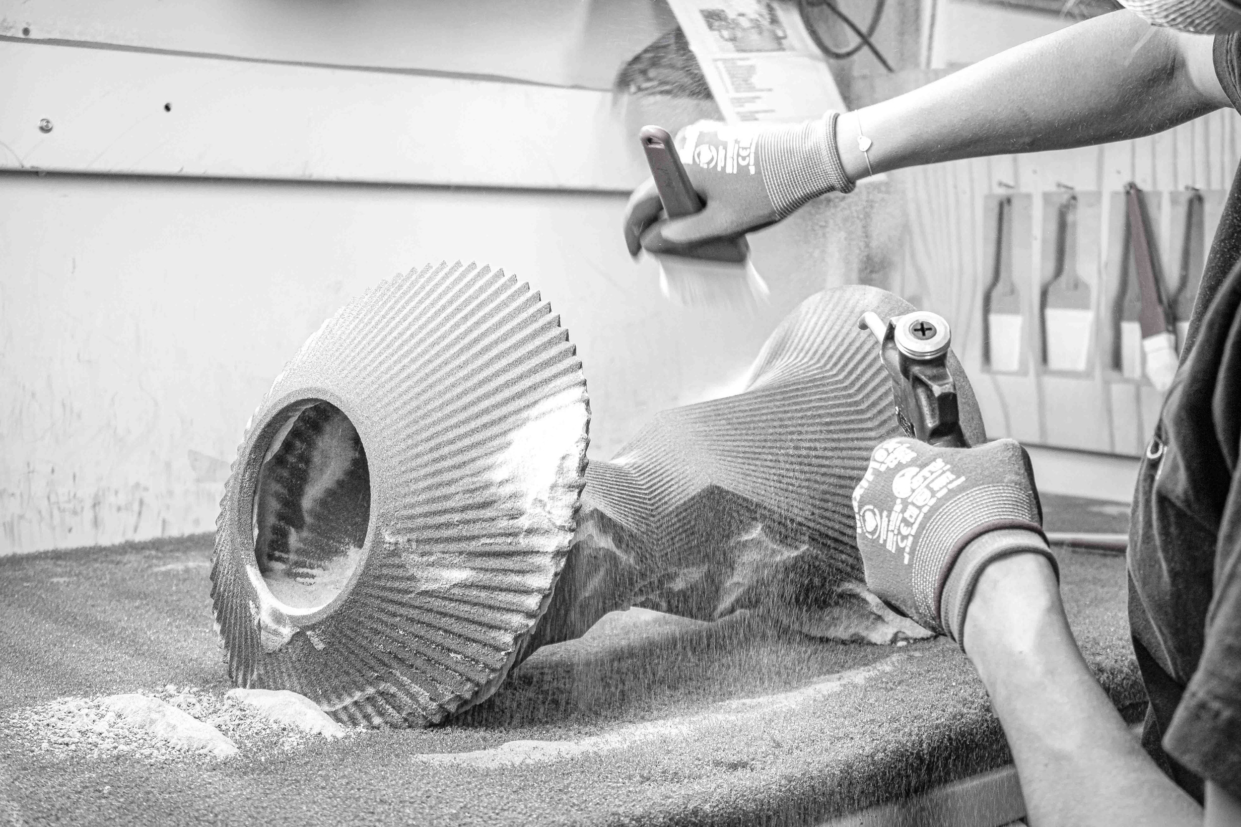

Ribbing on vase
I would love to get help to do this on Grasshopper. I tried on Rhino 8 but to no avail.

Hi Laurent
I am just trying to improve myself on Grasshopper, I see that this design would only be able to be done on a parametric program like Grasshopper. I tried on Rhino with Circular Array , I can’t get the reversal of direction midway of the height , I was hoping to get some clues! not ā€œtry moreā€

I’ll do something like that
Make a shape (tube like)
Make a curve that cut the shape in 2
Apply the ā€œfinā€ tool on both shape with some attraction on the naked edges,
Don’t forget to inverse the fin inclination on both shape in order to have this kind of interlocking aspect.
Make a STL and send the design to Sandhelden, you’ll have an instant quote (I made 3 thinks with them). It was half the price from classic 3d printing company (sculpteo, shapeways …)

Thank you for your answer. I am not a professionnal, I am an 80 year old amateur who loves to play with Rhino as a ā€œpasse timeā€. I tried to do this vase on rhino by making a cylinder with a curve line in an angle against to cylinder and used Circular Array (80). The problem I hvae is the reversal at mid height. Then I tried to extrude each blade. I deleted the file ( I was frustrated) but I will redo it again and send it to the forum . May be someone can point out what I am doing wrong or guide me in Grasshopper? all the best .

I’m happy to help you get started Marcel - I remember when I was in your situation. The GH file I posted is a bit more complex than it probably should be for someone just starting, but it was the best example I found that had geometry similar to what you wanted.
What helped me get going was to decide what geometry would give me the result I was trying to design, and then use whatever GH components were needed to make that geometry. The only thing I use Rhino for is to output files I’ve Baked from GH. That does limit my abilities compared to most people here, but it works fine for me.
And it is much appreciated. I have started to play around but God! it’s difficult. Can you tell me looking at the attached, which component do I use to array the vertical line around the 2 circles and the array of the vertical line to go from point to point the circles?
Cheers
Marcel
Trying array point to point.gh (7.6 KB)
You have a top circle.
You have a bottom circle.
Divide top curve (you’ll get points)
Divide bottom curve (you’ll get points)
Connect the points with a line / curve.

You need to internalize your data - else you’re just sharing empty files. Right-lick on your curve container > Internalize Data. Do that for all of them or whenever you’ve got reference geometry.
Both inputs to Seam should be lists of the same length. ā€˜C’ has 35, ā€˜t’ has 36.
The Range ā€˜N’ input needs an ā€œx-1ā€ expression.
