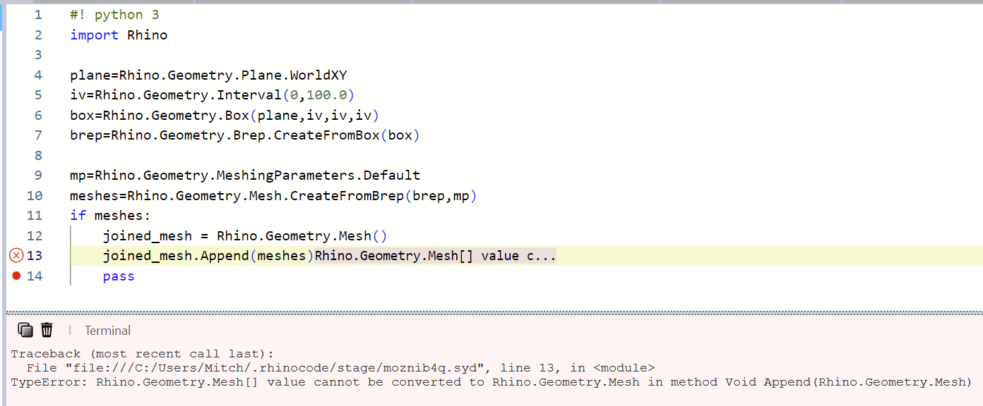

Here’s one I found today:
This runs fine in Python 2:
import Rhino

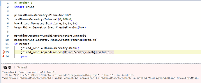

Running it in Python 3 ends up with this:
In order to make it run in Py3 it is necessary to do this:

if meshes:
    joined_mesh = Rhino.Geometry.Mesh()
    joined_mesh.Append(list(meshes))
IIRC, there have been a bunch of issues like this with methods not outputting basic Python lists…
I agree there are issues that we need to tune up with CPython 3 in Rhino, but since CPython 3 was never in Rhino 5,6,7 it seems like something different than what I assume Pau is referring to.
Is this a bug or am I doing something wrong?
This way it works:
All the bugs I’ve seen are things like this. Some of them I see that are being corrected with the Service Releases.

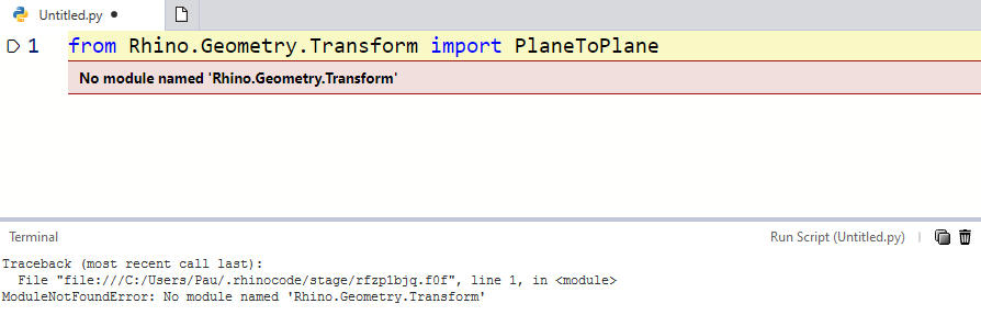

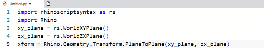

This is Python 3, and apparently not considered a bug. You can no longer import ‘static’ classes like that.
from Rhino.Geometry import Transform as XF
xform=XF.PlaneToPlane
#etc.
Thanks @Helvetosaur!
