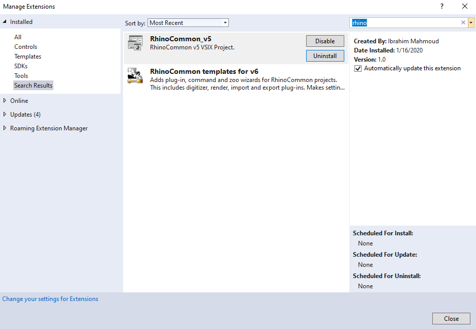

That’s interesting, all I had to do was click on the .vsix file to install it, restart all running instances of VS (otherwise the template won’t load), and then locate the template in the “New Projects” window. Here are screenshots of the steps I took:
Opening “Manage Extensions” shows me this:
While this doesn’t directly relate to your question, I should mention that I do not yet know how to make the template change the name of the initial files and classes depending on the inputted project name, and so you’d have to manually replace “RhinoCommonv5TemplatePlugIn” and “RhinoCommonv5TemplateCommand” with whatever names you desire (but it shouldn’t take too much time, maybe less than a minute of work).
Aside from those things, I didn’t do anything else special (unless the template only works on my machine somehow). Let me know if you have any further questions!
