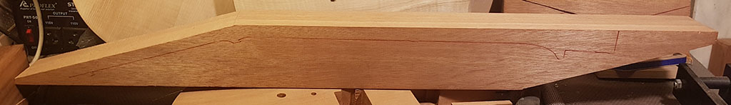

Hello, I’m a little confused. I have a wood with a length of 900x72x65mm that was previously thickened for the model to be milled. When I try to generate the toolpath, I do not know how I can control the depth of the milling machine in detail, without wasting much time.

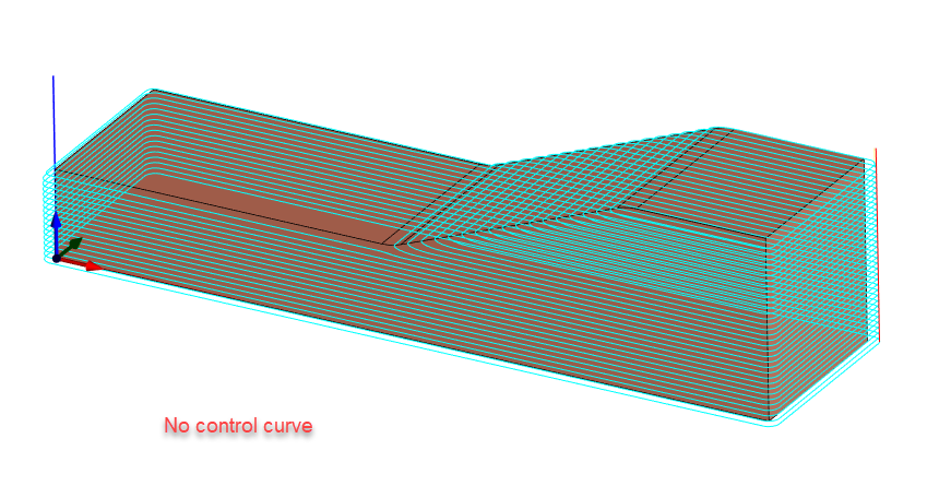

Did you try creating a closed curve as a region? Keep the distance less than the radius of the tool and the tool won’t drop down the sides.
You could also add some surfaces under the part surfaces that don’t allow the tool to go down the sides. But personally I would use a closed curve to control this if it was me.

You may need to look at some tutorials on creating limiting regions then. In pretty much all RhinoCAM 3D operations, you have a “Regions” tab where you can choose one or more closed regions to limit the toolpath to. Create your curve beforehand with Rhino tools - can be anything a closed polyline, circle, freeform curve etc. - then start the Mop, go to the regions tab and select the curve. Then fill in the rest of the operation parameters and generate…

In the illustrations above I just used a simple rectangle. It’s quite easy to do as Mitch explained, but knowing how to do this is vital to success with RhinoCAM, or any CAM program.

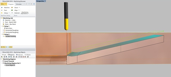

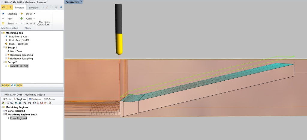

Hello, I tried this option but, the problem is this: if I do not activate “step-down Z cuts” everything goes perfectly, but I do not have control of the milling cutter in the material, when I activate “step-down Z cuts” the mill begins to cut the material regardless of region.
Can you post a sample file with the toolpaths - difficult to see exactly what’s happening from the images.
In general though, a parallel finishing toolpath is just that - one pass (no step-down) over the area after a previous roughing toolpath has removed most of the material.
From what I could see in the video, looks like all the ops stayed within the region boundary. Maybe I don’t understand what the problem is then. Are you saying the Z levels are not cut in the right order?

I want the Z level to start from the created region, not from the material level, because it was previously cut.
Ah. Look in the same Z-Containment dialog just above where you set the Z steps. There you can set a max Z and a min Z to limit the operation. You should set the max Z to the height of your region (or whatever you want).
In general a region’s Z level is not considered for limiting operations - only its projection in XY. Regions can be anywhere in Z and still limit the toolpath in the same way. It’s like looking through a window onto the part.

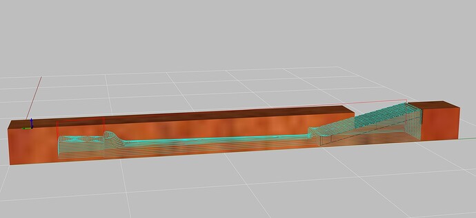

I already tried, it doesn’t work. One possible solution would be this (the movie). But there is definitely a professional option.

It does, but perhaps not the way you are expecting it to. Stepdowns are always horizontal to the machining plane, not offsets to the toolpath itself (which is what it looks like what you want). In the Pro version you can instance toolpaths in Z, or as you showed, even with the Standard version, copy the operation one or more times and set a stock to leave.
I still don’t know why this is needed though, the most often used procedure is a rough which removes most of the material, followed by a finish path. Often if I want to level off the large steps left from the roughing operation, I use a “semi-finish” pass in between, which is essentially the same operation as the finish pass, but with a small stock to leave (like 1mm) and a larger stepover. That flattens out the steps and leaves a more or less uniform material thickness for the finish pass.
