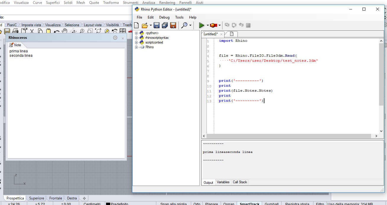

I’ve found some issue using RhinoCommon DLL for open a .3dm file outside Rhino 5.
The issue is about reading the “Notes” (http://docs.mcneel.com/rhino/5/help/en-us/commands/notes.htm) of 3dm files.
To obtain the right version of libraries outside Rhino 5’s environment I’ve followed the directive from this guide for windows.
I did some tests and I noticed a different behavior, what I want to achieve is the same behavior using the Python engine inside Rhino outside with another python script.
Example:
I did those test using the Rhino3dmIO on a Windows 10 (64 bit), the same hardware where I compile the DLL using Visual Studio 2017.
Using the same script above on a brand new installation of IronPython 2.7.7 I obtain a different behavior:
Only the last line was red.

This was probably my fault. There was something wrong in my port of file3dmio in the way utf strings were handled. There’s a commit from 7th of december that fixes this.
