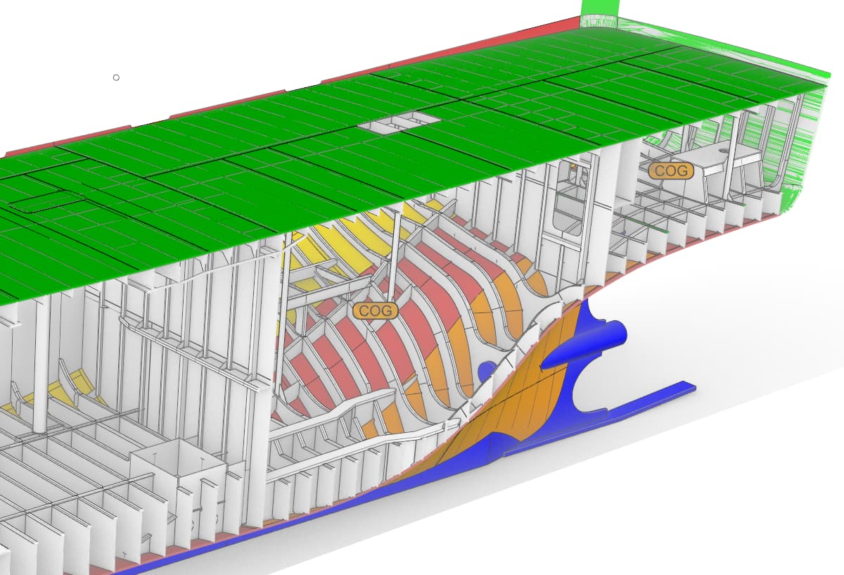

Being able to load all of the structure for a vessel in Rhino and quickly do sections, clipped views, centres of gravity, weights and explanation notes for the folks in the yard is a big time saver over having to wait for Solidworks to load, rebuild and then think about whether it is going to calculate accurate weights for assemblies. I think the WIP is a big step forward over 7 for this, especially if these niggles can be sorted, so thanks for all the hard work. My balance of work done in Rhino to that in Solidworks has significantly moved to Rhino in the past couple of years, as Dassault see to have given up on Solidworks users that do more than assemblies with a couple of hundred parts (presumably trying to drive us to CATIA?).
