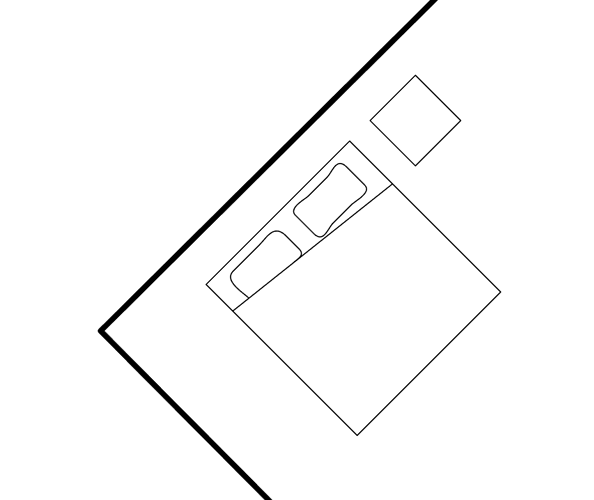

I have experienced this problem from time to time over the last few years. Sometimes when I export curved linework to illustrator, the lines come into illustrator distorted when they are not in Rhino. I believe I have solved this before with setting my tolerance past .001; however, I wonder if there is a setting I am overlooking.
i am assuming you are mentioning the right side pillow, and my suggestion would be exploding it before exporting it. because AI’s math is not good as rhino. its a issue about the degree i guess.
Yes it is the right pillow. I will explode it and check the results.

Attached is an image of my continuing problem. Simple curves are distorted. Circles are turned into filleted rectangles ( I know this is possibly a result of control points).
I wonder if I convert the nurbs curves to arc with the ‘convert’ command; however that should not be necessary.

Thank you for your response. I have attached the simple version of my file. I have a more complex one with more lines if this one works too easily. Thank you again for helping me solve this.
Works OK here, but for scaling to work, move the objects to the world origin - otherwise they are way off of the AI artboard. Here’s my export at 1"=1".
One of the things I see is that some of the curves which appear to be lines are not actually lines. If you first run SimplifyCrv, then SelLine and lock all of the lines that were selected, you will see some curves left over (see attached). Turn on control points for these curves and you will see that they are degree 3 and that the control points at the ends actually fold back in on the curve. I imagine that Illustrator doesn’t like this very much… How were these curves produced? Did Make2D do that?
Still, the AI export here looks OK in Illustrator, despite the bad curves…
I exported with ‘simplifycrv’ and the export works. Without the command it has issues so this is nice to know.
Nevertheless, I cannot figure out how to select the crvs not affected by ‘simplifycrv’ command? After I run the command how do you select these crvs?
Thank you again, simplifying the curves seems to solve my problem
