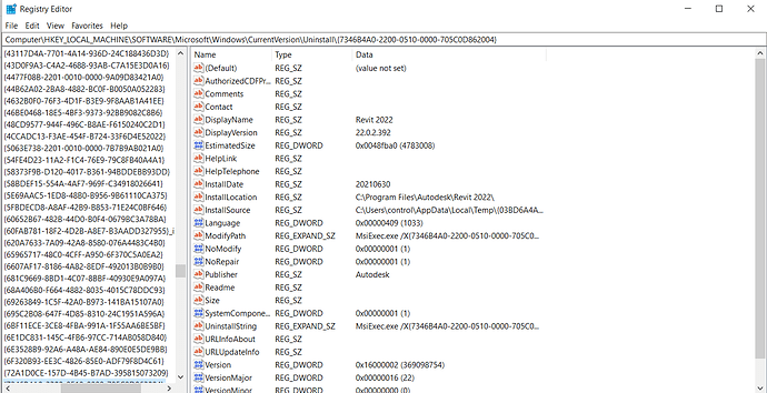

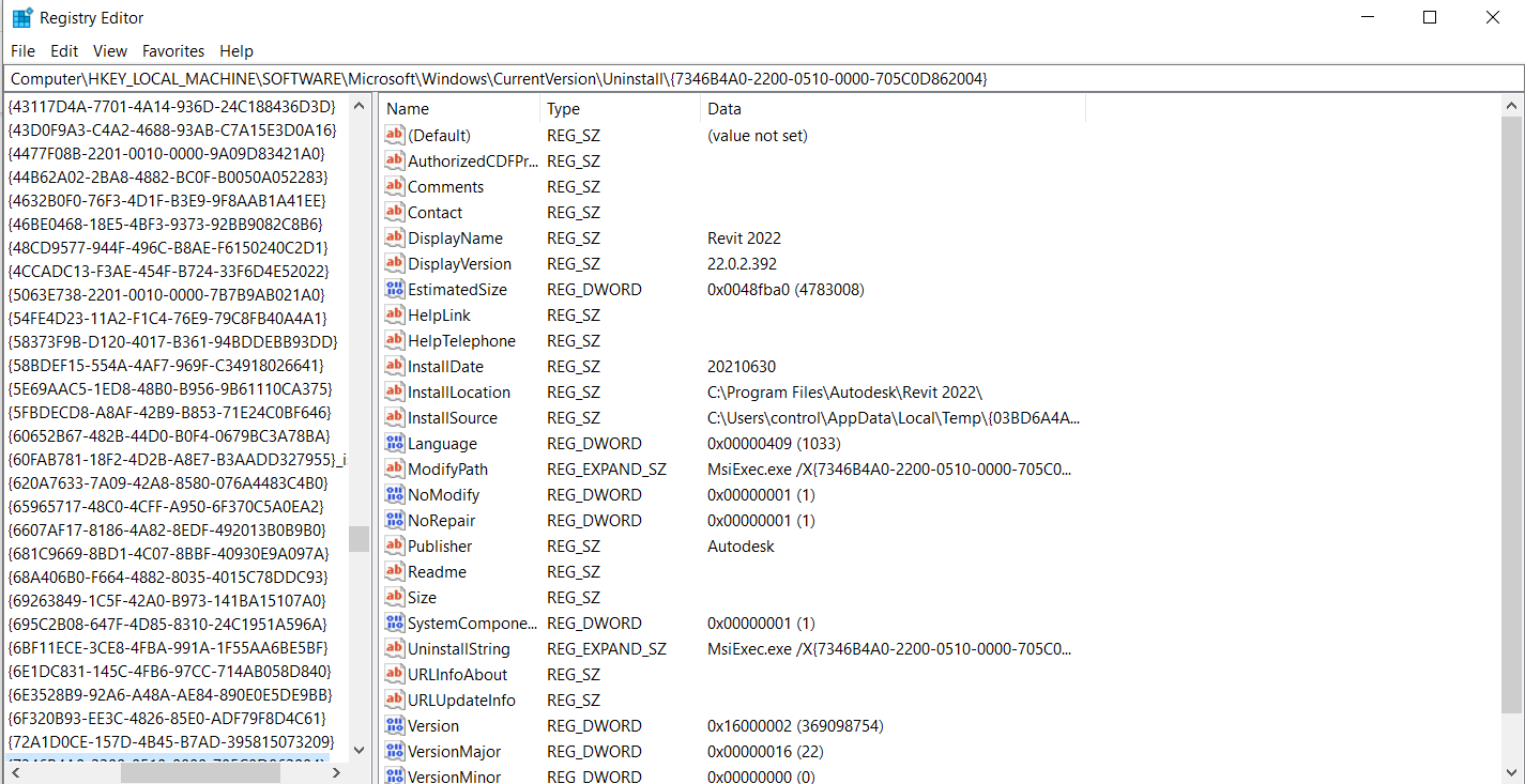

Rhino.Inside wont start for me in Revit 2022. I do not recieve any errors, when I click the toggle it just does not react. I am using the latest Rhino.Inside installer.
I have seen checked everything discussed in the post, but this did not solve the issue. https://discourse.mcneel.com/t/rhino-inside-wont-load-in-revit-2021/100769
RhinoInside.Revit can be found in the following folder: %PROGRAMDATA%\Autodesk\Revit\Addins\2022
Also the registry key seems to be correct:
Can you please help me with some suggestion how to proceed to solve the issue? Thank you!

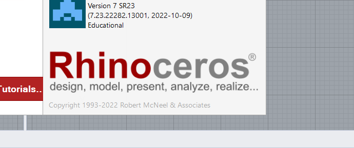

Thanks for your reply
I am using Rhino 7 SR23
The RIR I am using was downloaded from here:
Have I missed out anything?

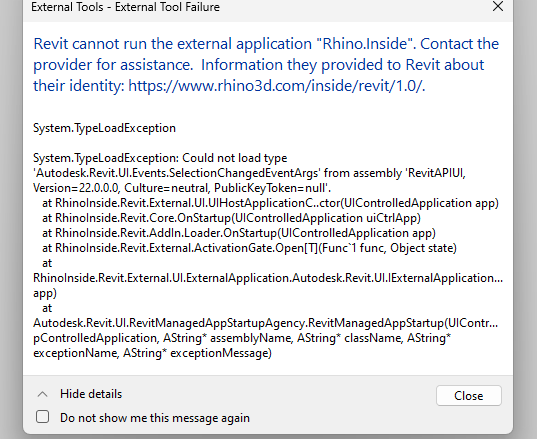

I am having the same problem.
Japhy
(Japhy)
August 8, 2023, 2:02pm
12
Does RiR load without additional Revit Addins loaded?
Can you provide the About info as described here… Rhino.Inside®.Revit
arqueiro
(Arqueiro)
August 8, 2023, 2:56pm
13
This as a fresh install of Revit 2022. The solution is installing all the updates and then install rhino.inside.
