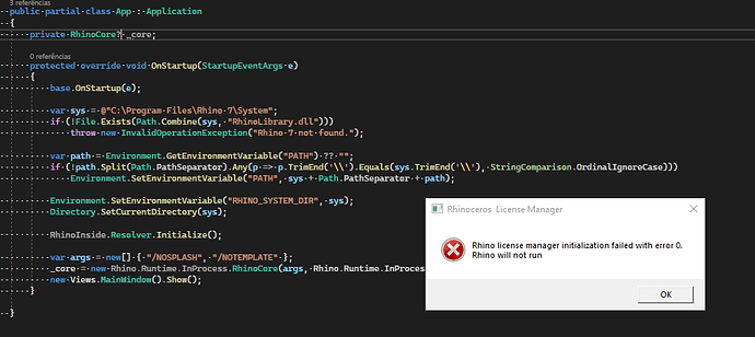

Hi! I’m trying to host Rhino 7 via Rhino.Inside inside a WPF app and I’m running into license
Environment
  • Windows: [Windows 10]
  • Rhino: 7.38, 64-bit (standalone Rhino launches fine with my commercial license)
  • Host app: WPF, net7.0-windows (x64), Rhino.Inside NuGet 7.0.0
  • Build: x64, Prefer32Bit=false, not single-file
Problem
  • When I start the app, I get:
    “Rhino license manager initialization failed with error 0. Rhino will not run.”
  • If I change WindowStyle to NoWindow, the error becomes a COMException E_FAIL at new RhinoCore(...).
  • This happens whether Rhino 7 is already open or closed.
What I’ve tried
  • Only Rhino.Inside package; removed any direct references to RhinoCommon / RhinoWindows (and removed any copies from bin).
  • Followed Ehsan’s guidance for WPF entry point (use a custom Program.Main, call RhinoInside.Resolver.Initialize() before touching any Rhino types; don’t set PATH or change CWD).
  • First run with WindowStyle.Normal (not Hidden/NoWindow), to allow license UI if needed.
  • Cleared env vars that might interfere: RHINO_PLUGIN_PATH, RHINO_COMMON_DIR, RHINO_LICENSE_METHOD.
  • Cleaned bin/obj, repaired Rhino 7 installation.
  • Confirmed Rhino 7 launches normally outside my app (license OK).
Questions
  • Are there known causes for “license manager initialization failed with error 0” when hosting Rhino 7 via Rhino.Inside?
  • Is there any additional requirement for the License Manager plug-in to load under Rhino.Inside (e.g., specific env vars, plugin path assumptions)?
     public partial class App : Application
            private RhinoCore? _core;
            protected override void OnStartup(StartupEventArgs e)
                base.OnStartup(e);
                var sys = @"C:\Program Files\Rhino 7\System";
                if (!File.Exists(Path.Combine(sys, "RhinoLibrary.dll")))
                    throw new InvalidOperationException("Rhino 7 not found.");
                var path = Environment.GetEnvironmentVariable("PATH") ?? "";
                if (!path.Split(Path.PathSeparator).Any(p => p.TrimEnd('\\').Equals(sys.TrimEnd('\\'), StringComparison.OrdinalIgnoreCase)))
                    Environment.SetEnvironmentVariable("PATH", sys + Path.PathSeparator + path);
                Environment.SetEnvironmentVariable("RHINO_SYSTEM_DIR", sys);
                Directory.SetCurrentDirectory(sys);
                RhinoInside.Resolver.Initialize();
                var args = new[] { "/NOSPLASH", "/NOTEMPLATE" };
                _core = new Rhino.Runtime.InProcess.RhinoCore(args, Rhino.Runtime.InProcess.WindowStyle.Hidden);
                new Views.MainWindow().Show();
Hi @Lucas_NG,
Rhino 7 targets the .NET Framework 4.8.
– Dale
