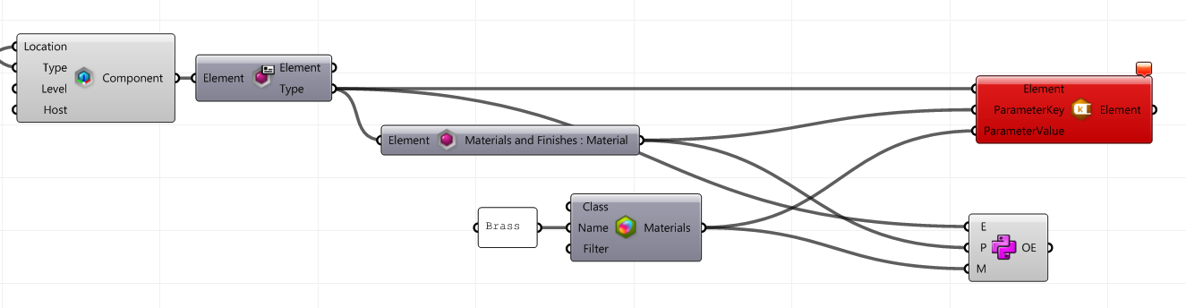

Rhino.Inside offers the function to change element parameters, however for some reason I cannot address the ParamterKey Structural Material . This material should be generated from the Revit material library. As you can see, also the Parameter Key gets an error.
I also tried it with a create material component, but this also did not help.
So, how to correctly assign a (structural) material from a Revit material library to an element?

try getting the key from the inspect element
Thank you Rickson!
I tried to get the key, but unfortunately it did not work with structural material…
I got this error:
However, the element is not in a different document.

That might be a different issue, have you updated to the latest release?

I believe he was referring to the WIP release available through the RiR tab (more pulldown on left)
