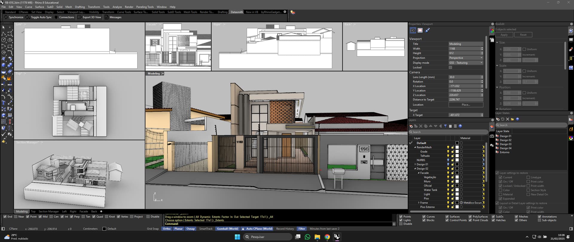

Hello, my fellow Rhino3D architects. I’m a newly graduated architect from Brazil, and I’m trying to transition from using AutoCAD (floor plans) > SketchUp (3D modeling for rendering) > AutoCAD (final documentation) to a workflow with Archicad (floor plans) + Rhinoceros (3D modeling for rendering) > Archicad (final documentation). Does this workflow make sense? Using Archicad for floor plans, Rhinoceros for creative 3D modeling, and returning to Archicad for proper documentation? If so, how do you do it (or how would you do it)?
I export a 3DM file with a basic model from Archicad, but when I import it into Rhino, all the objects, walls, and geometries come in as blocks, which makes editing very inconvenient. Imagine having to edit every wall individually every time! Not to mention that these blocks are categorized into layers—walls in the wall layer, furniture in the furniture layer—but all the geometry inside the blocks ends up on other layers, seemingly chosen randomly, from those imported from Archicad. For instance, if I explode my wall blocks, they might move to a terrain layer.

Heres that block layers bug, and you should notice that walls are separated from each other.
And here’s an example of architecture we model here in brazil.

Hello, I am from China, so my English is not very good. I hope I can express myself clearly. If your design is not particularly complicated, you can actually solve all problems in Archicad. For more complex parts, you can use Rhino and then import the model into Archicad using AC Connection (which requires some knowledge of Grasshopper, but it’s not complicated). Option two, if you really don’t like working with Archicad, you can do all your design in Rhino at the beginning of the project, and use Archicad as a tool for drawing. After the project stabilizes, you can fully transition to working in Archicad.

I feel like Archicad limits my way of thinking about geometry, so I chose this workflow for now (Archicad > Rhino > Twinmotion > Archicad). I think the texturing system in Archicad is what I dislike the most. I’m facing some challenges, but the users in this forum always help me solve them or adapt to the situation.
I’ll try using the AC connection. I’m actually a Grasshopper user too, but since I’m using Rhino 8 and people say it doesn’t work properly, I’ve never tried it.
