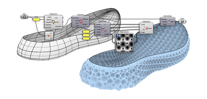

How to use it
Step 1: Unroll the 3D Object
Use ShapeSolver components to unroll the 3D object, similar to the Flow command. Set a line (placed near the 3D object) as the L0(ShapeLine) , and set a new line as the L1(Target Curve) to define the unrolled border’s position.
ShapeMapDemo0.3dm (135.2 KB)
Step 2: Design the 2D Pattern
Design your pattern, ensuring all curves remain within the boundaries of the unrolled border curve.
Step 3: Map the Pattern Back to 3D
Use MapToShapecomponent to accurately project the 2D pattern curves from the unrolled layout back onto the original 3D object.

1. Image Module
You can apply a texture on a 3D shape based on a bitmap module. See the example below, or refer to the tutorial for detailed instructions.
