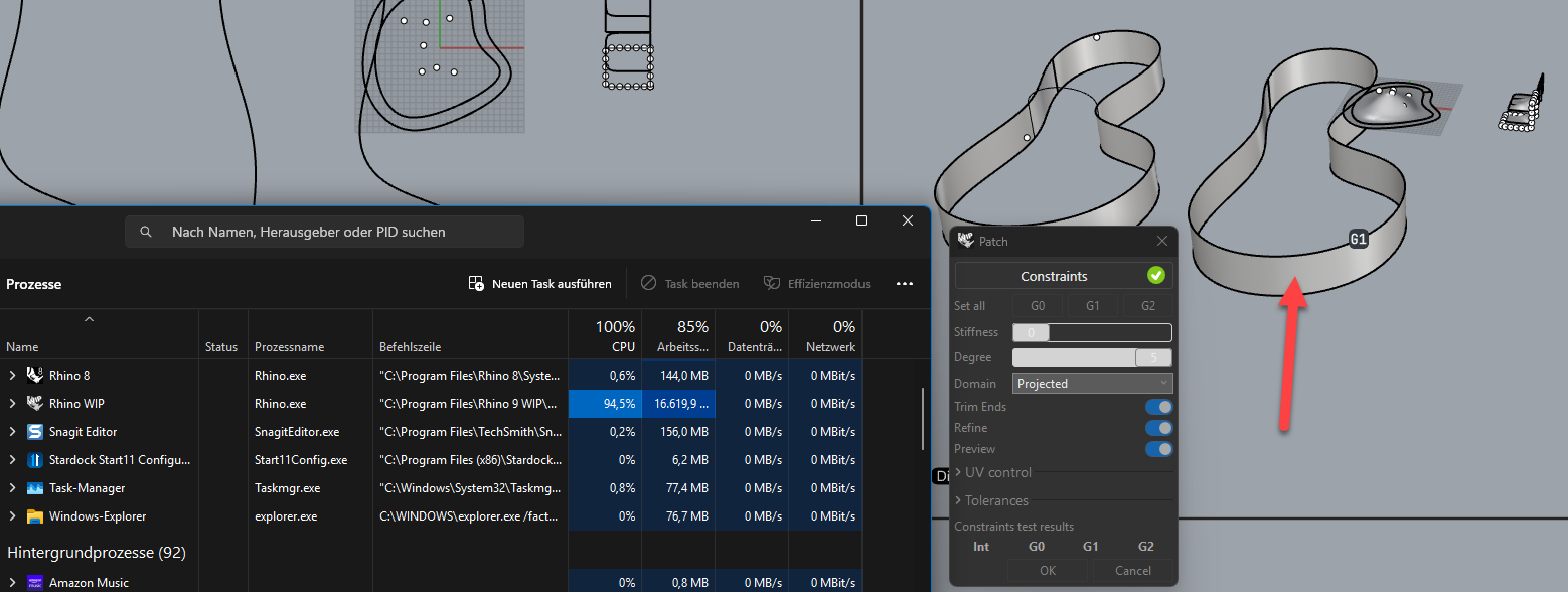

The middle shape doesn’t work at all for me.
Rhino eats some GB of RAM and uses 100% CPU for a few minutes:
The preview doesn’t show a useable result:
without any guide curves or points that will not work. that only works with the initial patch so far. in this case you have to use PatchOld or whatever its called now in the wip.
i still hope we get a symmetry option for new patch formerly FillSrf
@Charles vertical walls without any guide curves or points is a current known issue/limitation

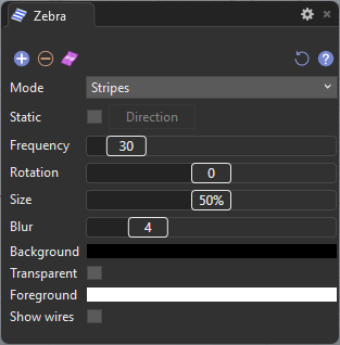

zebra for instance is also running in parallel but there if the panel is active you can close it with esc.
another exception is BoxEdit which has become a full blown panel that can always stay open, though it acts like a command and you have to apply the changes to take effect.
its all a bit too much there and back with no clear distinction in my opinion.
i personally would keep commands act all the same as commands. anything else that should/could stay open should just be a panel already. zebra definitely could also be a panel instead of this hybrid thing.
Zebra is a panel
Ok, then it should fail quicker and give some useful info.

sorry, I forgot that it isn’t dockable yet on the Mac.
In here Zebra doesn’t look like this, while I wish it would:
yeah, I’m not sure what the reason is that analysis panels are treated differently. IIRC there are plans to change that.
It isn’t dockable on Windows, don’t know about Mac.
It is dockable on Windows, but not as a tab like you showed in your image.
