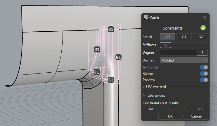

Command Dialog and Options
Constraints
Click on the [Constraints] button at the top to add/remove curves and points to the constraints. Hover over the green check-mark to reveal a red cross that will clear all constraints. The constraint curves and points will be labeled I, G0, G1 or G2 with their selected continuity. Left- or right-click on the labels to change the continuity to the next or previous continuity; Shift+left/right-click will change all contraints at the same time. Setting all constraints can also be done by clicking one of the buttons in the dialog below the [Constraints] button.

UV control (expert option; expand to see details)
Options here allow for a fine control of the domain and surface structure. UV rotation will rotate the surface by the given amount of degrees. This can help to make a fit at the cost of having more of the surface not participate in the patch. U- and V-spans will increase the number of starting control points and clicking the Starting surface button will let you select a starting surface whose degree, number of control points and knot vectors are used as input.
Tolerances (expand to see details)
The position, normal and internal constraint tolerances can be set in the Tolerances fold-out.
Constraint test results
At the bottom of the dialog, you get quick feedback whether constraints have been met within tolerance. The Int, G0, G1 and G2 text will be green if the tolerance was met, red if the tolerance was not met or grey if that type of constraint is not present.
