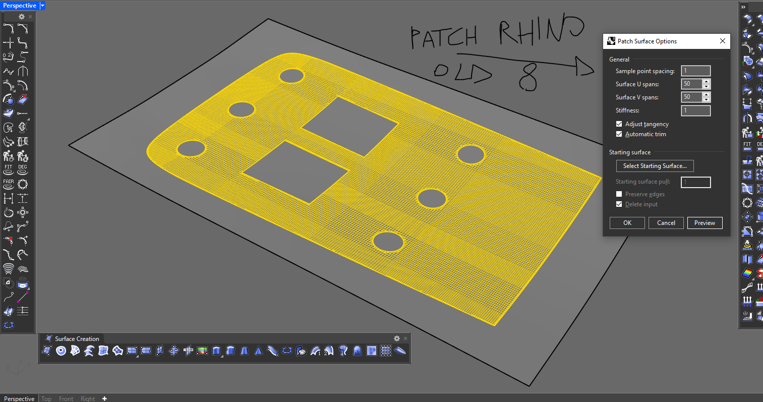

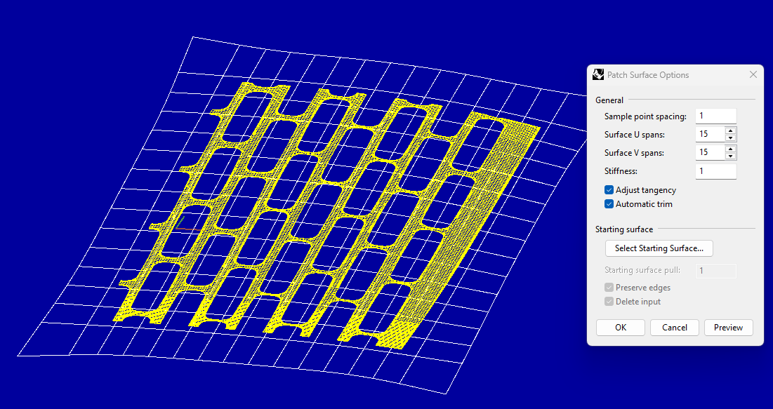

A user on the Italian forum pointed out that if the Patch command (currently OldPatch in the WIP version) gets replaced, a useful functionality is lost. As shown in their example – and confirmed by a quick test I did myself – using Patch on a mesh or surface grid works, whereas using the FillSrf command or the current Patch does not allow it.
