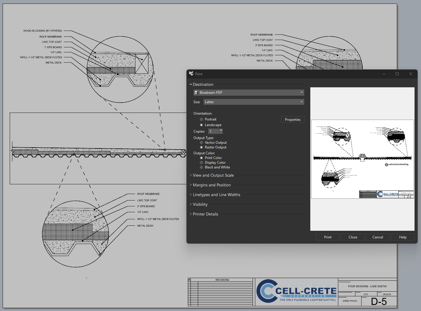

When I try to print it to a PDF I have to raster output otherwise, it will show the entire drawing instead of just that window/boundary.
This is what happens whe I select Vector Output. I need these drawings to be crisp.
What am I doing wrong??
hi @Jorge_Ponce1 thanks for reporting, this seems to be broken
RH-88921 Non rectangular details don’t work in vector printing
Hi Gijs,
Thanks for the confirmation, I thought I was doing something incorrectly. I will use the raster output for the timebeing while this gets fixed.
Thank you,
RH-88921 is fixed in Rhino WIP
