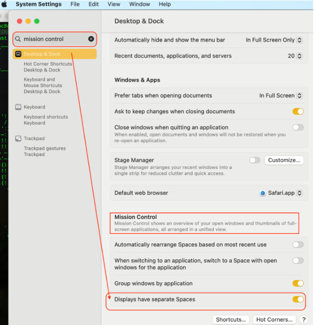

Hi, just adding one more data point for the thread… running into exactly this issue on an MacBook M3 Max with a Studio Display. Runs fine when the Studio Display’s unplugged, but getting multi-second intermittent redraw freezes / delays in the viewports (and four-up viewports often out of sync) when the display is plugged in.
As indicated in the SystemInfo, both the internal and external displays are at their default / unscaled resolution. Laptop display set to ProMotion (120Hz), Studio Display is locked at 60Hz.

Try toggling this option on.
@Japhy Interesting, that does seem to fix it!
Though enabling that setting is almost as big a threat to my sanity as the Rhino pauses. :sweat_smile:
HI @dan @Gijs sorry to be squeaky wheel here, but object lagging is still an issue. I know that it’s a low priority for you, but a fix would be a nice quality of life upgrade when working on complex models and drawings. As I’ve said there was no issue in R7, it’s a new thing for R8.
Thank you for the nudge. I was able to reproduce RH-79271 again today on two separate external displays. It does still seem like it’s tied to macOS Displays as separate spaces with external displays at non-native resolutions in those spaces (not news, just reiterating it).
