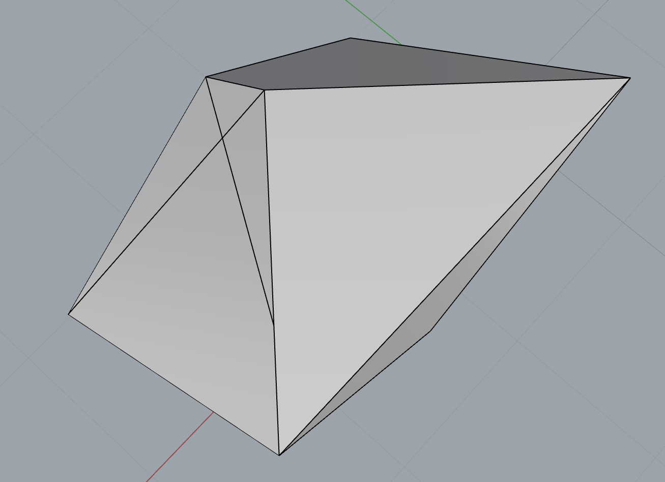

CreateConvexHull3D method returns an incorrect mesh.
Attached GH file with sample Python script including the point set that results in an faulty hull mesh. The resulting hull from the pointset should be octahedral. Note the one face with overlapping geometry.
I would be interested in a fix to the function or in a way to post process the mesh output to fix the hull.

Hi @Anton,
Thanks - I’ve logged the issue so a developer can have a look.
https://mcneel.myjetbrains.com/youtrack/issue/RH-85385
In the meantime, use Rhino’s PackageManager command to install RhinoPolyhedra. Then, use it’s QuickHull component.
correct hull.gh (6.3 KB)
– Dale
Great, I was not aware of this package. This solves my issue. Still good to get the function checked/updated if need be.
