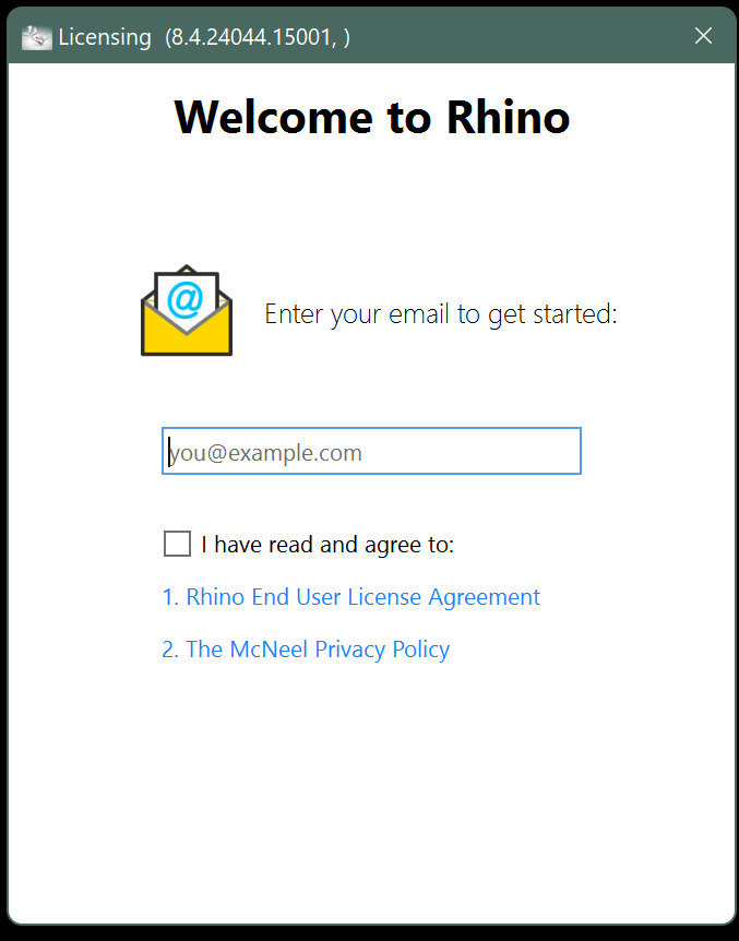

Hi, I have not gotten the pop up about a crash report at all actually. i just managed to open up rhino 8 and mess with a file for a bit, but then i quit and tried to reopen and got this error
i had actually gotten this before, but completely uninstalled all versions of rhino and reinstalled microsoft .net framework and did a repair of that for good measure and thought i got rid of the issue.
If i hit retry, that doesnt work, if i hit cancel it takes me to this screen where i can find my license and try to log in, but the error screen comes back
then if i cancel that error screen i get this one

A Repair install is better than uninstall in this case. Go to Add/Remove Programs>Rhino>Modify>Repair
I’ve just tried the repair install, computer rebooted. i still get the same error, i edited my last message with the different screens i got.
additional update: i just tried to install rhino 7, it has the same error now. any ideas would be appreciated. i would really rather not have to a full wipe on this computer…

Do you have any anti-virus that could be blocking a proper install?
Let repair your Redistributables and then Repair or Install again

No antivirus at all. I even have Microsoft Defender disabled.
I have a lot of redistributables. I repaired this one.
I have that .Net fixer, it hasnt helped.
well, i uninstalled Rhino 7 and 8, cleared out the %appdata% folder and then installed only Rhino 7. Its working so far. Will probably just avoid installing 8 for a while… if i can somehow help you diagnose this issue, let me know. =] Thanks!
Thanks for the update, that is the correct redistributable.
It would be interesting to see if you are getting errors running Rhino 8 in .netframework, so far this looks isolated to your environment, a symptom of something bigger going on.
Well you tempted me, so i installed 8 again and did the shortcut edit for the first run. then i was able to run SetDotNetRuntime and change to framework.
no crashes.
