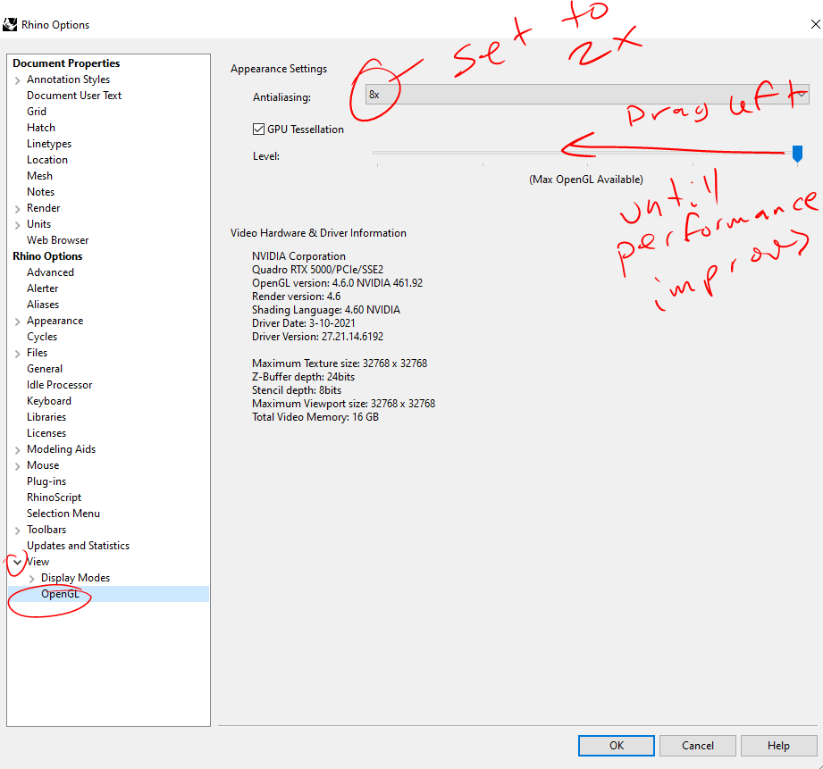

Whenever I try to open Rhino 7 up I have to click on the icon 18 and counting times. It shows the loading icon on the mouse and then disappears and nothing happens. I have talked to some of my friends in our class and the same issue happens to them, only I am less patient and want this issue fixed. It will end up opening but it just feels wrong for this to keep happening. I am constantly fearing my computer will shut down or update and Rhino will close bc it takes so long to open back up again.

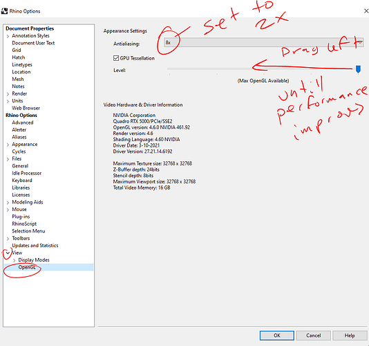

please run help>check for updates in rhino and grab the latest service release-
and also realize this machine is not set up well to run rhino. It’s below our spec of 4 gb of vram.
Once you update- you may try moving this slider to the left to see where you performance improves.
you may also want to update your intel driver here-
use the update tool-
