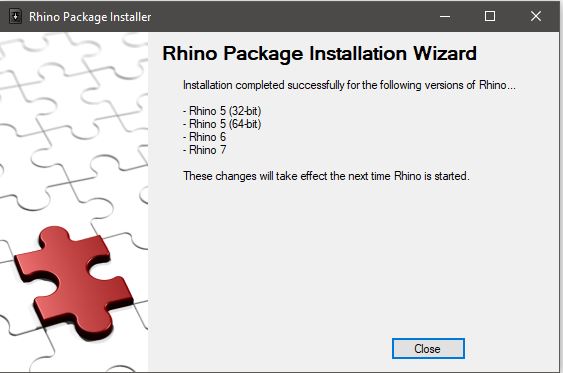

Unfortunately organizing it in folders doesn’t seem to do much.
It always installs in all Rhino versions. (I run Install for all users)
I only have Rhino 6 folder in there…
Capture
Based on the Marmoset example, would you say we should ZIP->RHI the main Marmoset folder, including it, or just the sub-folders structure? Either way (I tried both), it always installs into all Rhino versions.

Hi @Jarek,
as far as i understand, the folder names do not control this but the rhp file itself. The helppage mentions this at the bottom footnotes:
folder names are not important; the .rhp files themselves are inspected to determine for which versions of Rhino they will be installed
Imho, this makes the example harder to understand. Maybe @will can jump in here for additional help.

Hey @Jarek, I had chance to look into this quickly today and discovered that if you compile against Rhino 6 (Plugin settings > SDK > “C:\ProgramFiles\Rhino 6\System\RhinoCommon.dll”) then the resulting .rhi will not attempt to install the plug-in for Rhino 5. This way you can provide a “minimum version” for your plug-in.
Hi @will, does this mean that the plugin is then installed for the next higher Rhino version (Wip or Rhino 7) as well ?
_
c.
Yes, plug-ins created with the RhinoScript Compiler for Rhino 6 should be compatible with Rhino 7; the Rhino Installer Engine will install the plug-in for both versions of Rhino, if installed.
