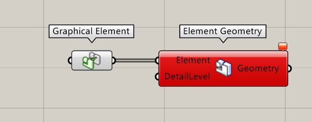

Warning notices:1. RhinoInside.Revit.GH: Find no way:“System.Collections.Generic.IList`1<Autodesk.Revit.DB.ElementId> Autodesk.Revit.DB.Element.GetDependentElements(Autodesk.Revit.DB.ElementFilter)”。

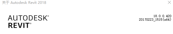

Is your Revit 2018.0 or 2018.1?
18.0
This component is using a method called GetDependentElements that is not present in Revit API until 2018.1.
I’m looking into this problem now, but meanwhile, if you can, I think you will be fine if you update your Revit to 2018.1.
