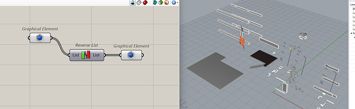

Hi Japhy, I think aside from how we can get the elements from the Revit model, what we are also noticing is that based on the list order you can see the bake would result in different elements, I have internalized the data which is based on the rac sample rvt file.
RiR_GraphicalElementRAC.gh (31.2 KB)
Interesting, i can repeat in the newer example as well. Nice find!
Hi Mohamed, This has been addressed in RhinoInside.Revit_1.32.9253.6062 and is ready for additional testing.
