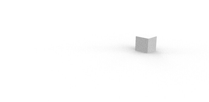

It’s been a few years now and I still haven’t worked out how to do this. I hope someone can help.
I added a box in Rhino at 0,0,0, with 10,10,10mm dimensions
I tried to add as one brep to the brep assignment component
This has been my point of reference, but some of the nodes won’t join up at multiple points as shown, and some of the expressions seem to fail because there is no “x” variable.
I will restate I am a total n00b to Rhino/Grasshopper and this project is really my first exposure to it. I’ve attached my project file, gh script, and a render of the result I’m getting. I hope someone can help me get to the result I was looking for.
truchet stepped shape.gh (23.2 KB)
truchet-stepped_231125.3dm (93.4 KB)
Here are my roadblocks:
“Parameter “Variable x” has an invalid name. Only use alphanumeric characters and don’t start with a number.”
Is the expression wrong? “0.5 - 0.5 / (2*x + 1)“
I’ve set the slider expression name to “x” just to be sure. By default it was blank. Confused.
Same again here
“if(x<0.5,0,π/2)“
I’ve assigned a Brep at an angle on the origin
I’ve checked all the wiring, and it seems correct.
I don’t see any result. What am I missing here?
Hello
It has been a long time !!!
If variable is named “x” why naming “variable x” ? just put “x”.
Here are all the scripts I made. Written 4 Shapes but as indeed 5 shapes/tiles !
stepped truchet 4 shapes LD.gh (27.8 KB)
stepped truchet LD.gh (27.4 KB)
stepped truchet 3 shapes LD.gh (30.9 KB)
