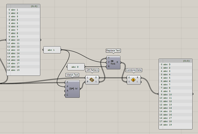

Hi, i would like to change ‘SNO 1’ to something else. However, ‘SNO 12’ is now also changed because it has got the ‘SNO 1’ inside of it. Is there any way to only change the actual 'SNO 1"?
Since you haven’t uploaded an actual file, maybe use member index to find the item and then replace item:
