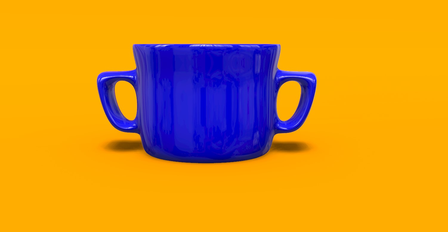

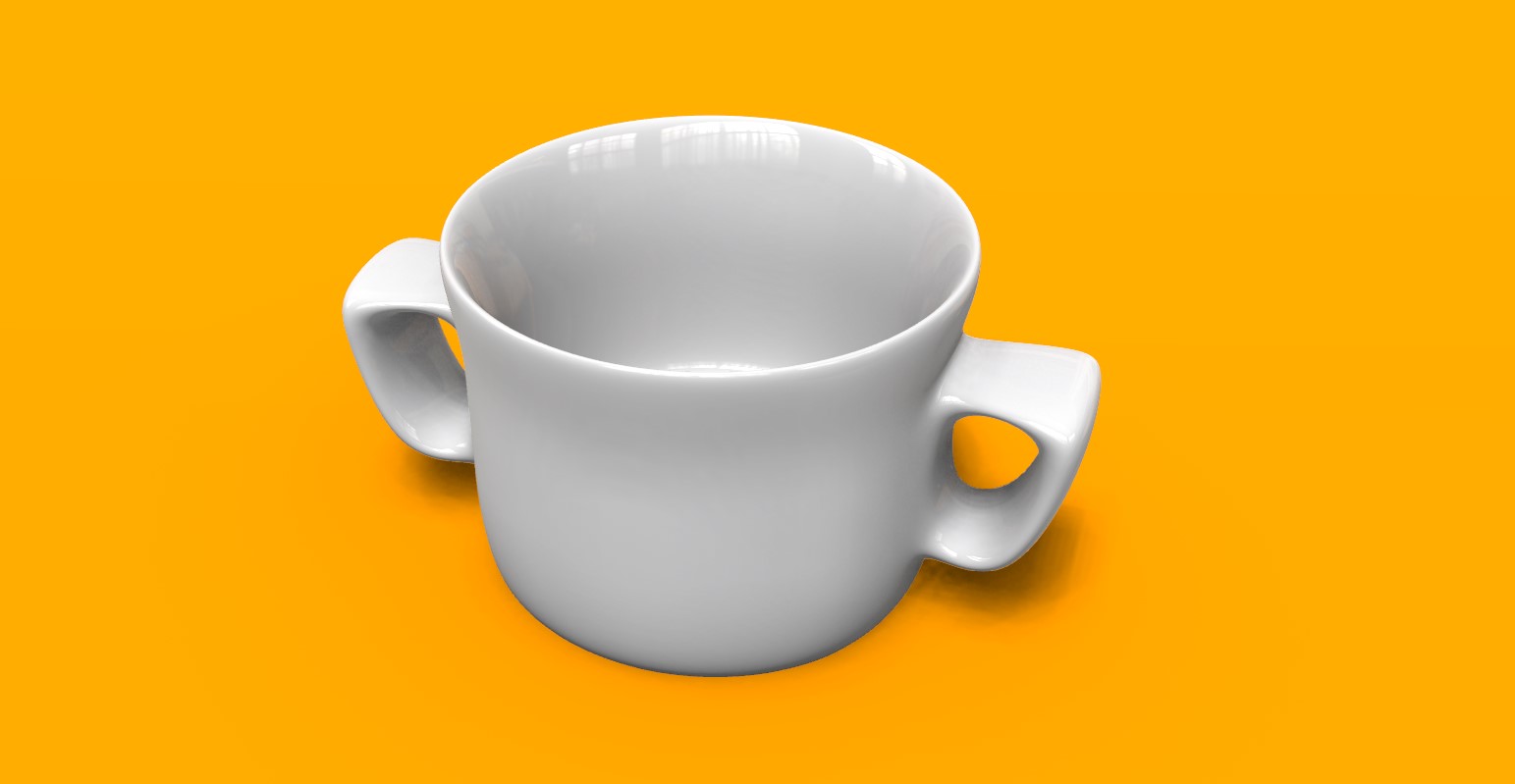

Render using Rhino 7. Hope you guys like it

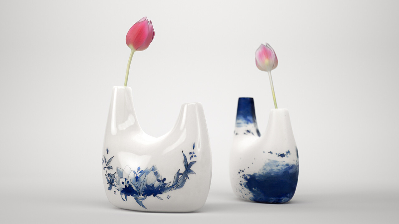

I would remove the oversaturated orange background (let your product be the “hero”), and also reduce the saturation of the almost “radiant” blue and red glaze. Then, use subsurface scattering for your porcelain or stoneware material, because light penetrates and is scattered inside the porcelain (bisque and glazed) and thin stoneware including the layer of glazing (but not terracotta and earthenware), and that will help you quite a bit with the realism.
Thank you, Lagom, for the tips. I will give it a try. Take care!
Maxwell render?
Yes, that was MR.
Are you still using this program? Do you have experience with the current version for Rhino 8?
I still use it a lot, but not with plug-ins (the data mostly comes from Alias, Creo, Fusion, or Rhino).

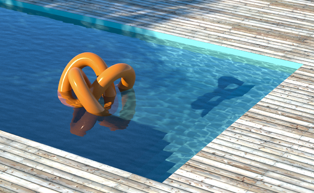

If Maxwell render were to continue to be developed, I would especially like: an increase in rendering speed, adding support for modern 4000 and 5000 series GPUs, improving GPU performance (switching from CUDA to Optix), improving VRAM usage, switching to modern OIDN type denoisers, etc. Improved plugin implementation, especially for Rhino. Full caustic effects (for example, pool caustics) and other modern features. :slight_smile:
It won’t be developed. It’s EOL since a few years.
Pool caustics are extremely time consuming to calculate, but there’s a great time-saving trick for any renderer.
