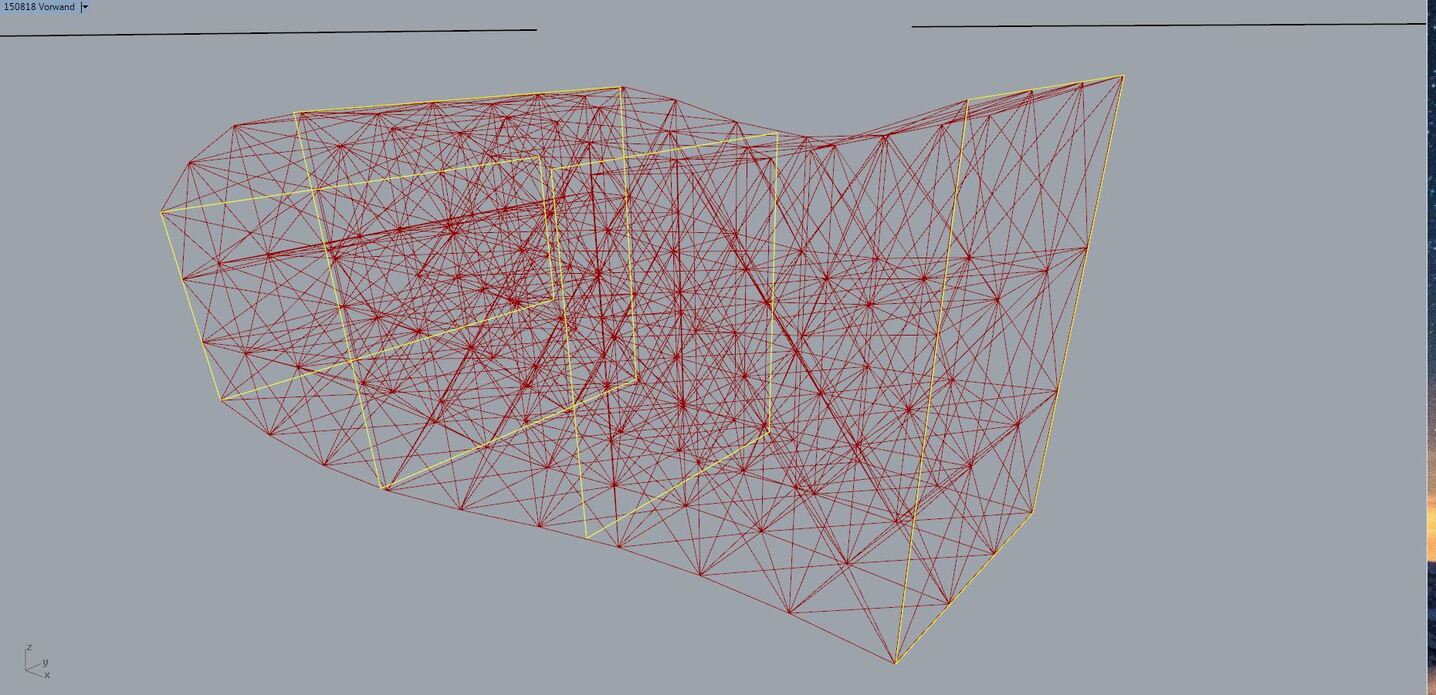

Here we have two examples that Relative Itemswas used several years ago…
HTH.
