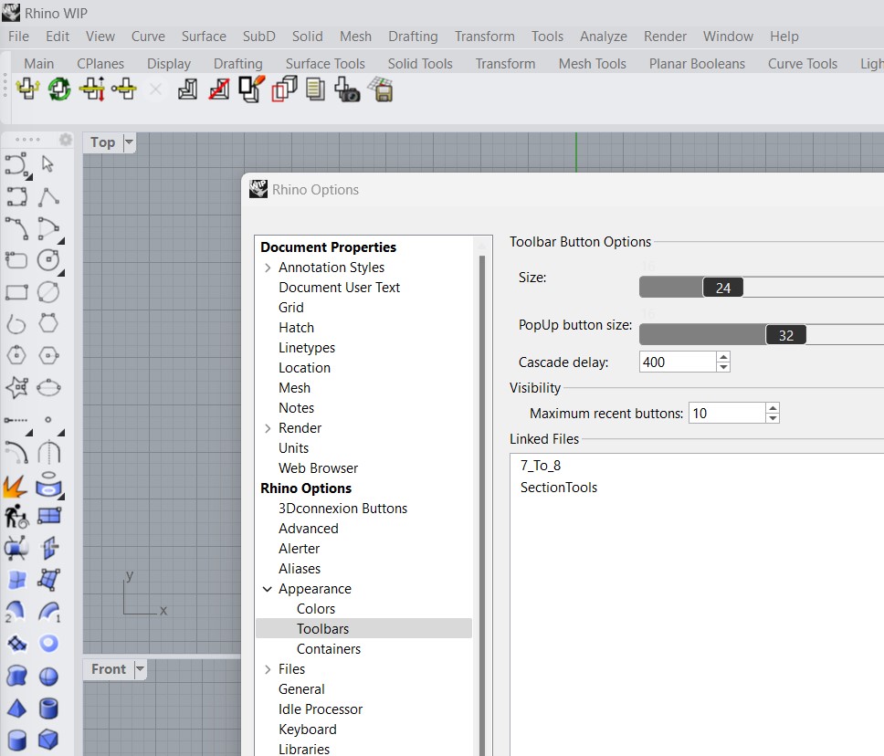

Can you post something like this as a comparison? This is a crop from 2560 x 1600 screen @150%:
On this screen the V8 icons look stronger, but crisper, do you agree on that?
@CalypsoArt do you have the same icon size set in both machines and what is the pixel size you are using? In the above example I have set icons to 24 pixels in Toolbar settings.
Both machines are set to 24. These are take from my desktop at 2560x1600 @ 125 scaling. They in no way look as good as what you posted.

@CalypsoArt Here is a screenshot of my 2560 x 1600 @125%, next to V7 with large icons, and next to that your screenshot. Do you have a highly customized workspace, otherwise can you do a _Reset and reset toolbar customizations?
Cheers Steve. Afraid I’m not seeing any/much difference at 125% on the 2023-05-09 build from my previous test. Also note how the Grasshopper2 icons look sharper/better than the Rhino 8 icons, I wonder if that’s simply because of their design/SVG files:

I do have a customized workspace with custom Icons I made for tools for plugin tools. However, as it is, I’m not using WIP8 because of this. What would you hope to determine should I reset? It is obvious from your post the V7 looks way better. The same I have here.

I’m confused with the screenshot you show in v8. Those icons look from before a change was made to the icons to give them a gray outline.
Running Reset and choosing remove toolbar customizations should improve things.
That being said there is still something to fix regarding crispness of the icons but that’s a different issue from what you are showing here.

OK, I’ve reset WIP8. The icons look better. But still not as crisp and finessed as V7.
@CalypsoArt Yes that looks more like it. If you now try to set your display to 100, 150 or 200% then you get to see what the crispness should be. There is a bug right now that makes things blurrier than needed at other scales.
In general v7 will look different. V8 has stronger icons.
