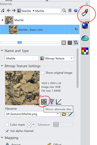

Hi @John_Williams and @tom5 ,
I found a workaround that may help you both. If you enable the “Mirror alternate tiles” option for the texture map, it updates automatically after saved changes to the file. Of course this isn’t a setting you’ll always want to use but it may not make a difference depending on your texture repeat and mapping. I’ve also let the developer who owns this one know about the workaround and asked if this knowledge can help them fix it in a v8 service release.
Textures still won’t refresh for me. ‘Mirror alternate tiles’ doesn’t help.
