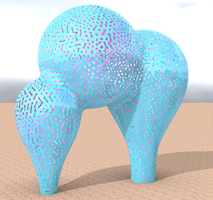

This is far from the same thing has lots of constraints are missing but some of the ideas are there.
First make some shapes, I used Rhinoceros for this part
Boolean the surfaces
Fillet the brep

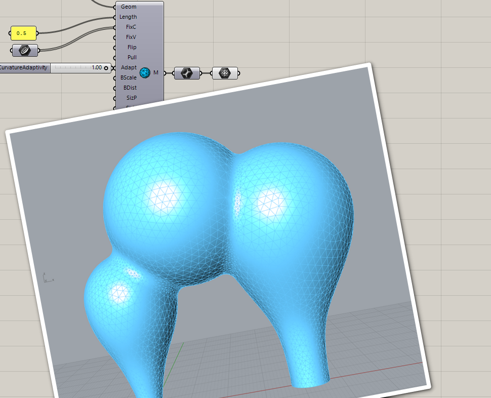

Mesh the brep with a triangular mesh (I used Remesh from Kangaroo 2). I will try with Meshmachine and having faces size depending on the curvature (like Pillars of Dreams)
Add some attractors points
Make the paths, I used here one of my script to make perfect Maze. In this part the path making is very important as there are 2 shells on the structure. And to have strength path from one layer to the other layer must cross perpendicular to each other. So this imply very specific script. Also some path follow the principal curvature on high curvature parts.
Here with Maze you have to choose 2 types of Maze for each layer.
Then you can control the effect of the attractor using some Graph Mapper
And using MeshMachineStatic with Curvature adaptivity
The logic of thickening the path is here

Use of Mesh Machine Static
