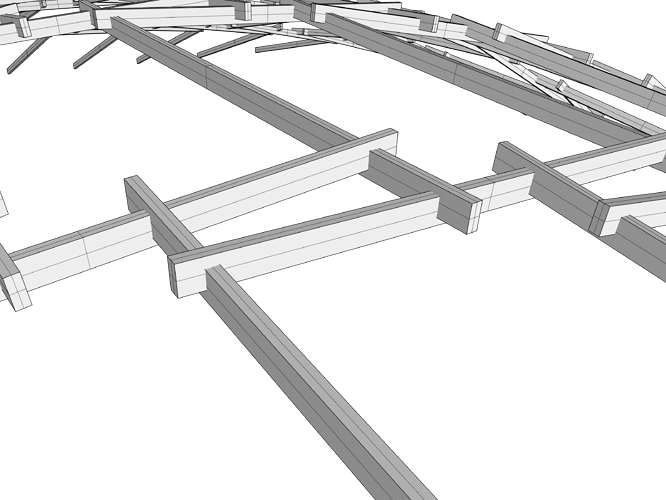

for a project at my university I am currently working on reciprocal frames. I have already created the general structure for my design, but I don’t know how to connect the individual bars.
Unfortunately, I also have little experience with grasshopper and would therefore appreciate any help.
It would be best if the bars were connected with a half lap connection, like in the picture.
I have uploaded the 3dm and the gh file with the reciprocal frame.
Greetings Ralf

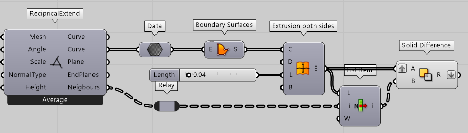

Hope there is a faster way.
Thanks for the answer, that has already helped me.
Would it be possible to make the cuts on both bars, as in the photo?
That is the connection I am looking for. I have now done this example with the moveface command in Rhino, but is there a way to solve the same thing with Grasshopper?

reciprocal half lap intersection edited.gh (31.6 KB)
There is an addon called Biber.
With this, you can easily create that kind of joint.

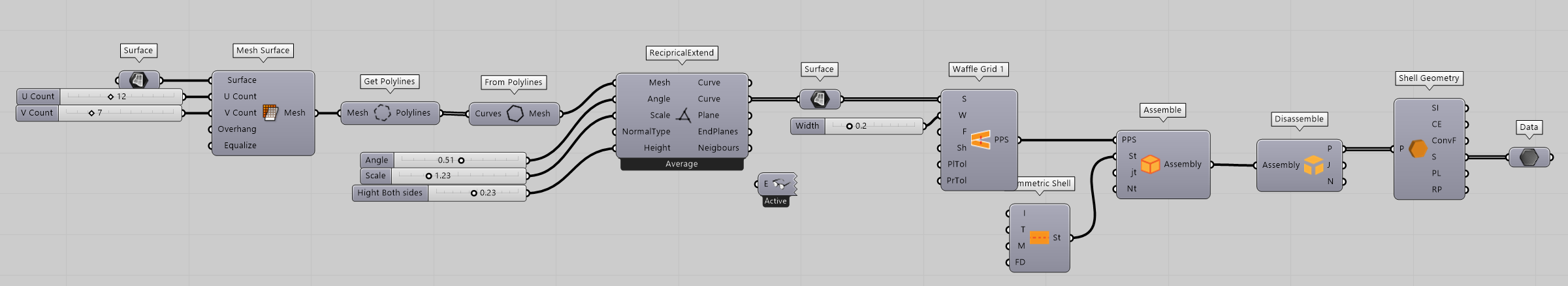

Please see my other post, you can make this with screw holes with the marvelous Ngon plugin.
[Ngon Plugin] Can’t get screw holes in a reciprocal structure - Grasshopper - McNeel Forum
hello, can you please tell me what are the plugins for these component- Waffle Grid1, Symmetric Shell, Assemble, Disassemble and Shell geometry? I have installed NGon, Lunchbox, Kangaroo plugins but didn’t find these exact components…
