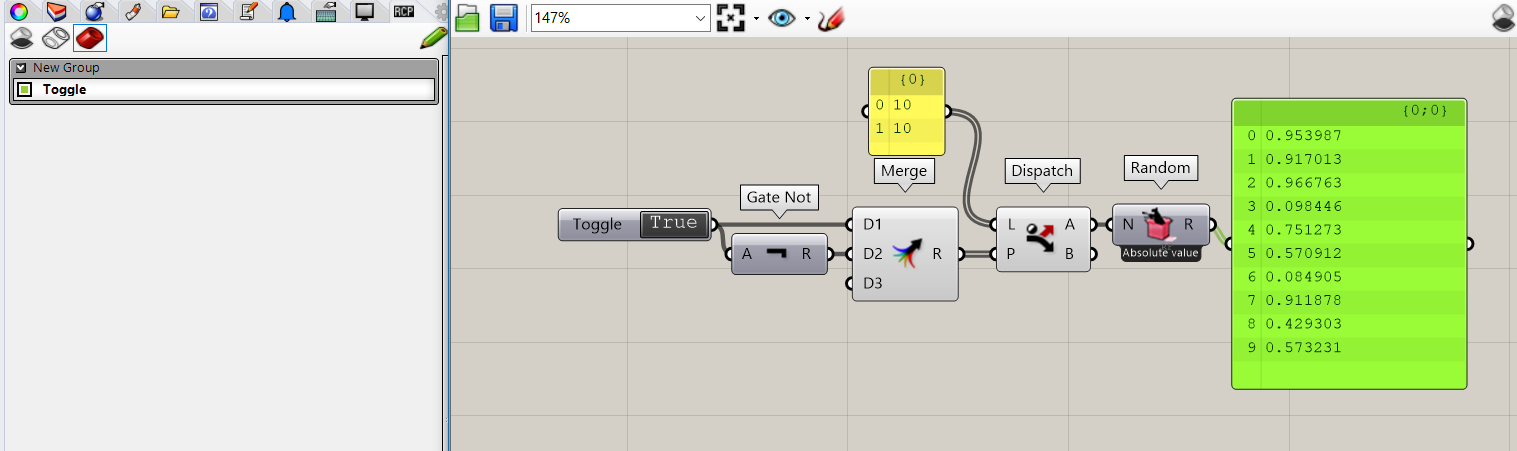

As you have a trigger in the UI it is easy to use it to change the random numbers. Here an example with Remote Panel, must be the same with Human UI
The toggle is true or false so it generate a list of (true, false) then (false, true) … so the dispatch will alternatively send a 10 or a 10. But Grashopper did not test if value are the same so the random component is recalculated. There are many many solutions …
thank you. I have a different random widget which has a seed input. Is it also a basic grasshopper widget?
This one is Heteroptera, it accept not a seed but a number of random numbers, if this number change (or not if we cheat) there is a recalculation.
