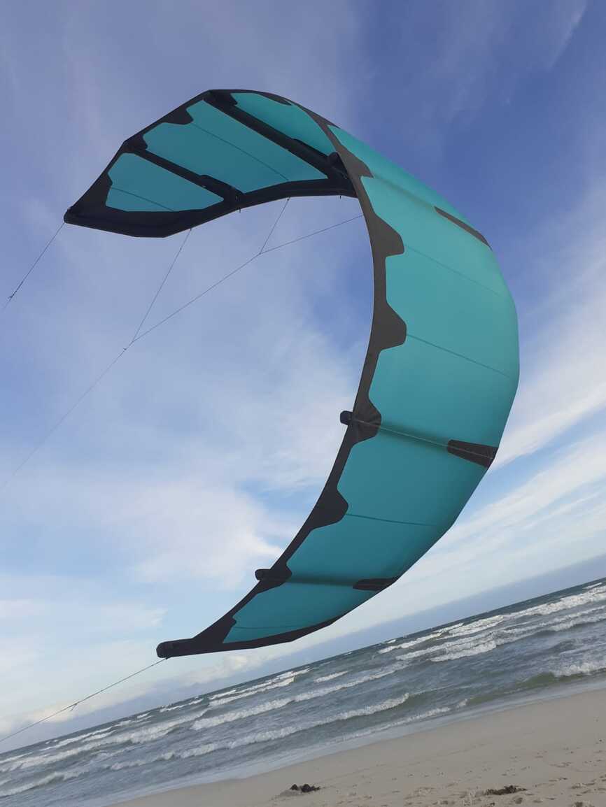

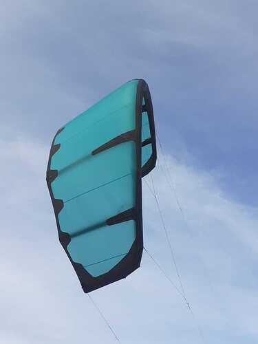

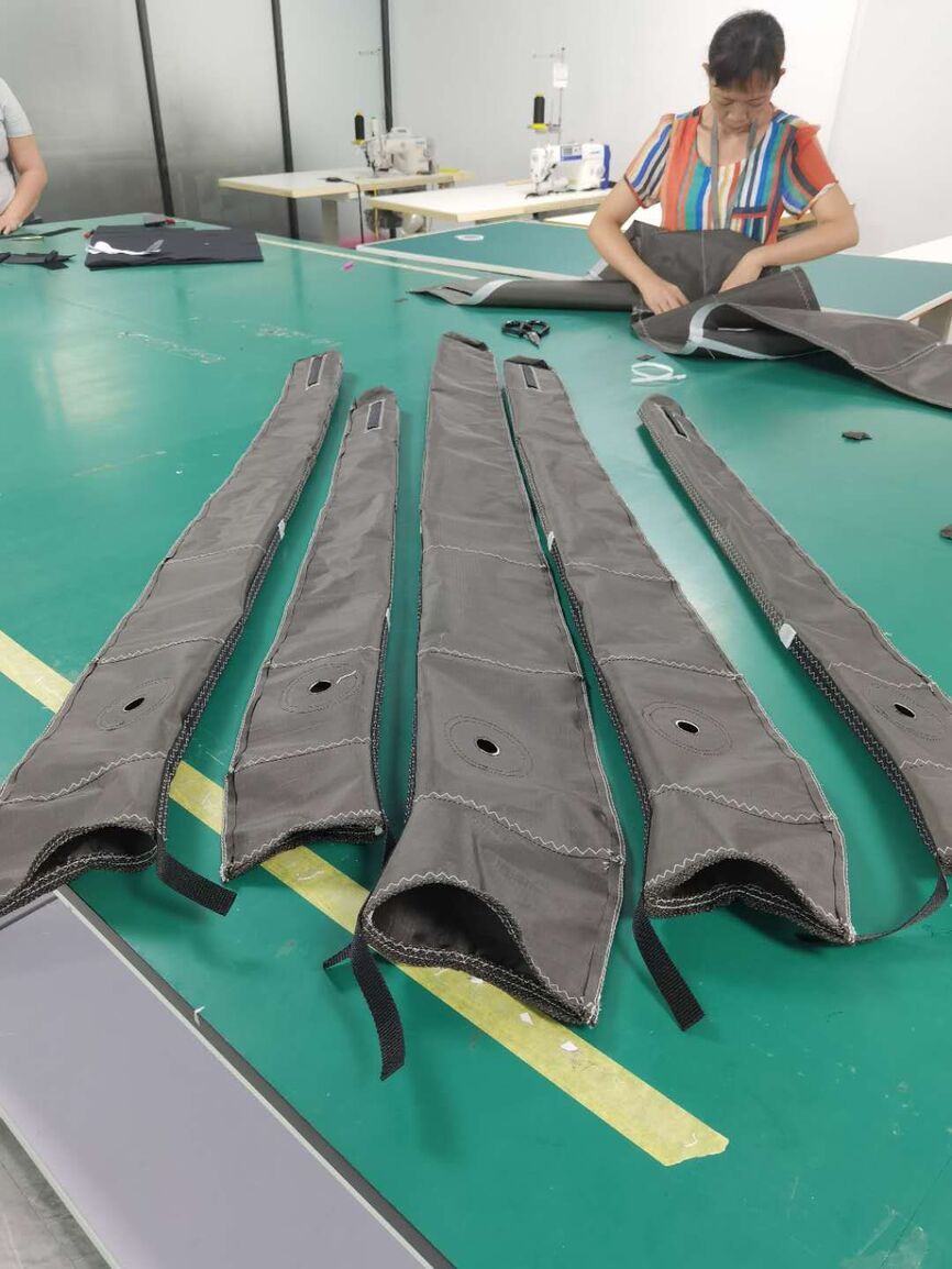

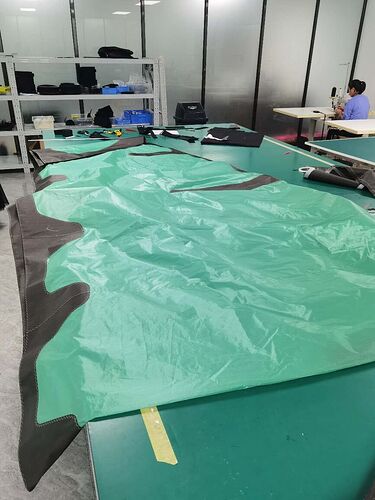

My latest kitesurfing kite - 9m, 5 strut, freeride/big air design:
3D model and cut files created 100% in Grasshopper:
Building pics:
Flying in Cape Town:
Very stoked on this one too, super fun to fly/ride.

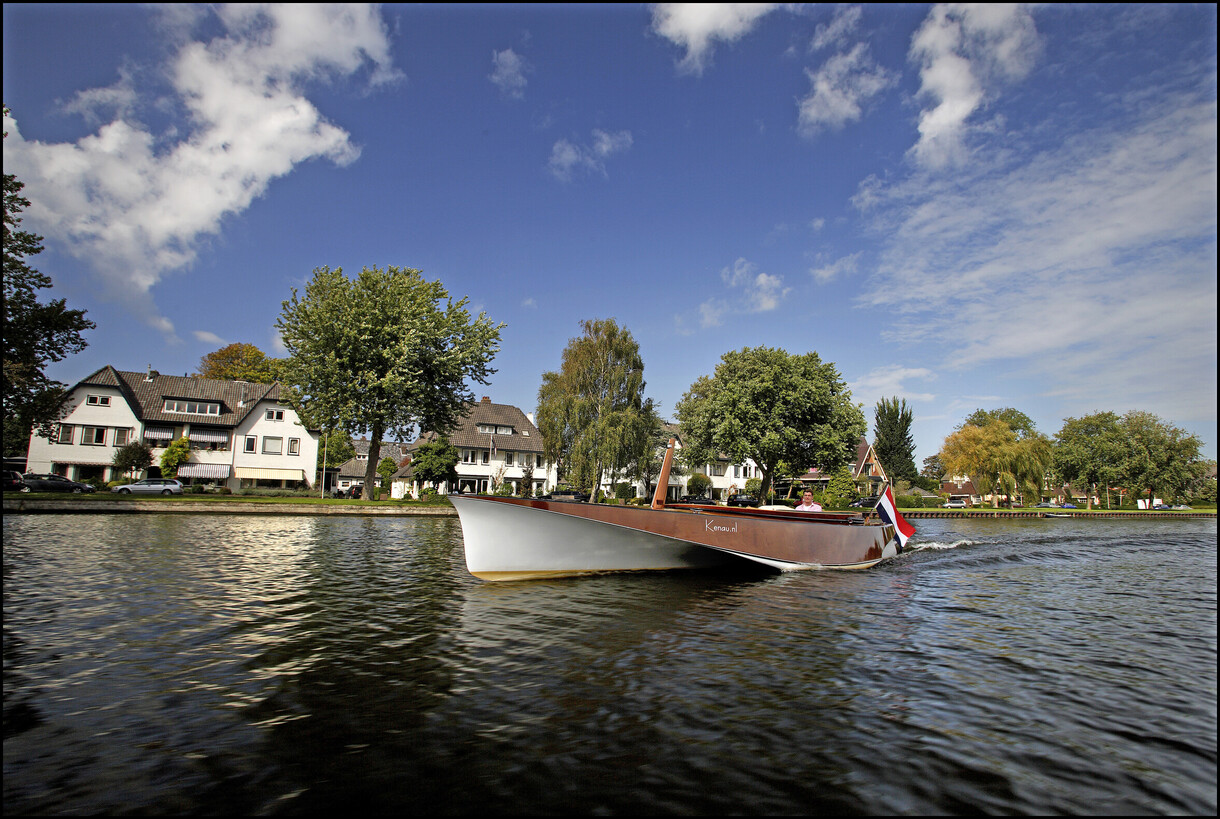

It doesn’t get any more “real life product design example” then this…
Thank you Wim,
Here are some other images.
The design was done in Rhino 1 and the demo boat was build from 2001 to 2005.
