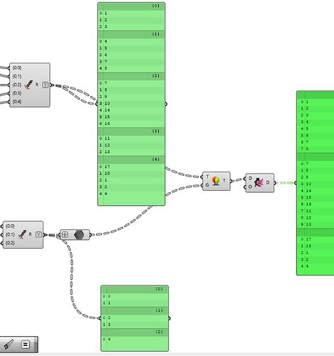

I am trying to re-arrange branches from a tree based on the structure from another separate tree.
As you can see below I have tree A and tree B. I would like to input the values of branches in tree A into tree B as if each value of tree B was a path of tree A.
Input:
Output:
I have managed to do get to the required output but with some limitations which are not acceptable:
  • Option 1, number of paths in both trees will vary and will most of the time not be equal and “match tree” component will not work for these cases.
  • Option 2, the number of path in tree B will be also varying and I will have to manually add output in the explode tree which is not practical.
I feel like I am missing something fundamental here as my understanding of trees tells me that the simple option 3 below should work but it is just giving me back the structure from tree A.
Thanks,
Arthur

Not sure if this is what you are looking for:
Redistributing Tree - Actual Trees_V2.gh (57.4 KB)
How you want get 53 branches ?
@Joseph_Oster Thanks! Your solution appears to work perfectly for my purpose. The use of the group component to input branches into a list item component in order to extract the branches is interesting and something I will try to use more.
