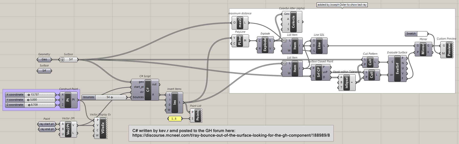

In Rhino there is a Bounce command, I’m looking for the exact same thing but in Grasshopper (Rhino 8). I saw some very old GH attempts somewhere on the Internet but they do not work for me. Is there a component that I might have just missed?
I just want to get a line bounced out of a surface.

Is it this simple? Substitute any surface for the sphere.
bounce_line_2024Aug2a.gh (8.8 KB)
P.S. Or simpler?
bounce_line_2024Aug2b.gh (7.9 KB)
Hi, sorry I know it should be easy in Grasshopper and it turns out it really is. Sometimes I try to solve problems in GH but end up complicating them. I just asked if there is a bounce component, you gave me a good, short solution made out of multiple components. Thank you.

Thanks for the component. It mostly solves the problem. However, Bounce command operates on an unsorted list of surfaces and rays can bounce multiple times from the same surface.
Using C# component surfaces must be ordered, which is only easy in simple scenarios. I can obtain multiple bounces by repeating surface inputs, but again it’s only feasible in simple cases.
Or a loop (white group) to repeat the process.
bounce_line_2024Aug5a.gh (27.7 KB)
My use case was simple, so I didn’t add complexity, it could be quite simple to bounce until a ray escape, also it could be better to use all sort of geometry as input (plane, surface, BRep, mesh,…).
I took shortcuts with the Anemone loop, assuming two planar surfaces with a single ray bouncing off the bottom surface first, even if it passes through the top surface. The loop could be modified to work with an unsorted list of curved surfaces. Multiple rays might be handled with nested loops, the outer loop going through a list of rays, one at a time.
However, creating a flexible test bench is almost more complicated than the Anemone loop, unless a static set of surfaces (and rays) is created in Rhino.
Perhaps something like this.
240805a_RayShoot.gh (10.9 KB)

Hah, nice test geometry! Very nice. Why does it stop?
P.S. I think I know - because the ray “escapes” through the gaps?
Correct.
With the gap closed:
Also, the order of the input surfaces does not change the results.
240805b_RayShoot.gh (13.7 KB)
Edit: removed plug-in dependency.
-Kevin

It’s very cool. Would be nice, and more intuitive, to see the escaping ray that I showed as blue in my loop. That part was not easy…
P.S. Jitter ‘J’ input defaults to 1 so no need for text panel.
Thank you, very nice solution.
Not to be too picky, but that would make it an ultimate solution. Also, right now this component is not very suited to situations where there is only one bounce. Of course, I can fix that with some script after the last bounce point is determined by the C# script.

In the meantime, I prepared something like this. Used C# component by @kev.r and some method posted earlier by @Joseph_Oster.
Ray Bounce 2.gh (37.3 KB)
In this script rays are separated into 3 groups: rays that do not hit any geometry, bounce only once, and bounce multiple times.
However, doing this I realized there is quite a big issue. Both Kevin’s C# component and Rhino’s Bounce command do not account for holes in the surfaces. You can see that the round hole is ignored.

Yes, the RhinoCommon documentation on the Rhino.Geometry.Intersect.Intersection.RayShoot() function states “Trims are ignored on Breps”
