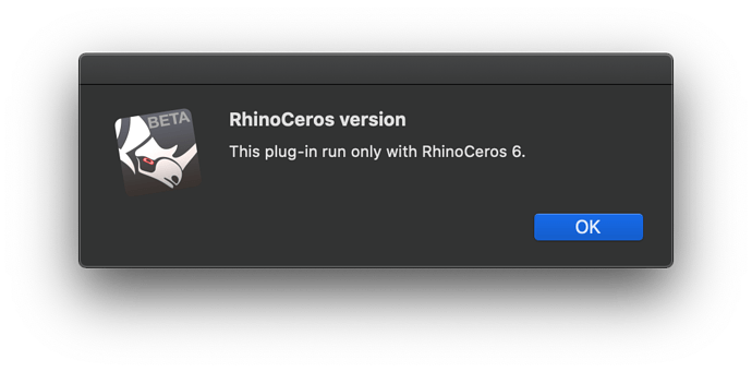

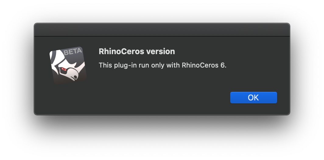

When I run the “Trace” command to call on the plugin, this is what I am getting.
Is it just possible that the plugin is just coded to do a version check before loading?
If this is the case, that is unfortunate due to the circumstances.
Im sure the plugin would have ran just fine without that bit of code.
That message is coming from the plug-in itself so it is checking the version of Rhino and deciding not to run. Not much we can do if the project is closed source and the developer passed away.
