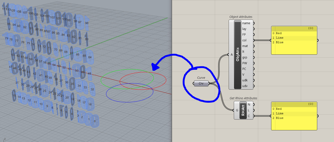

yes, you can extract those color info from referenced geometries
I use Human or Elefront plugins to do that, there might be more plugins and several different ways to get to the same result (but they lose those properties when they get internalized, so you won’t see them in the attached file: you’ll need to manually draw and give color to some curves in Rhino then reference them in GH)

I’m very interested in knowing more about this point,
I know you can reference text as curves (explode the text), but then all the letters/numbers composed by more than one curve are separate objects in GH… but for sure there might be better ways than converting text to curves
