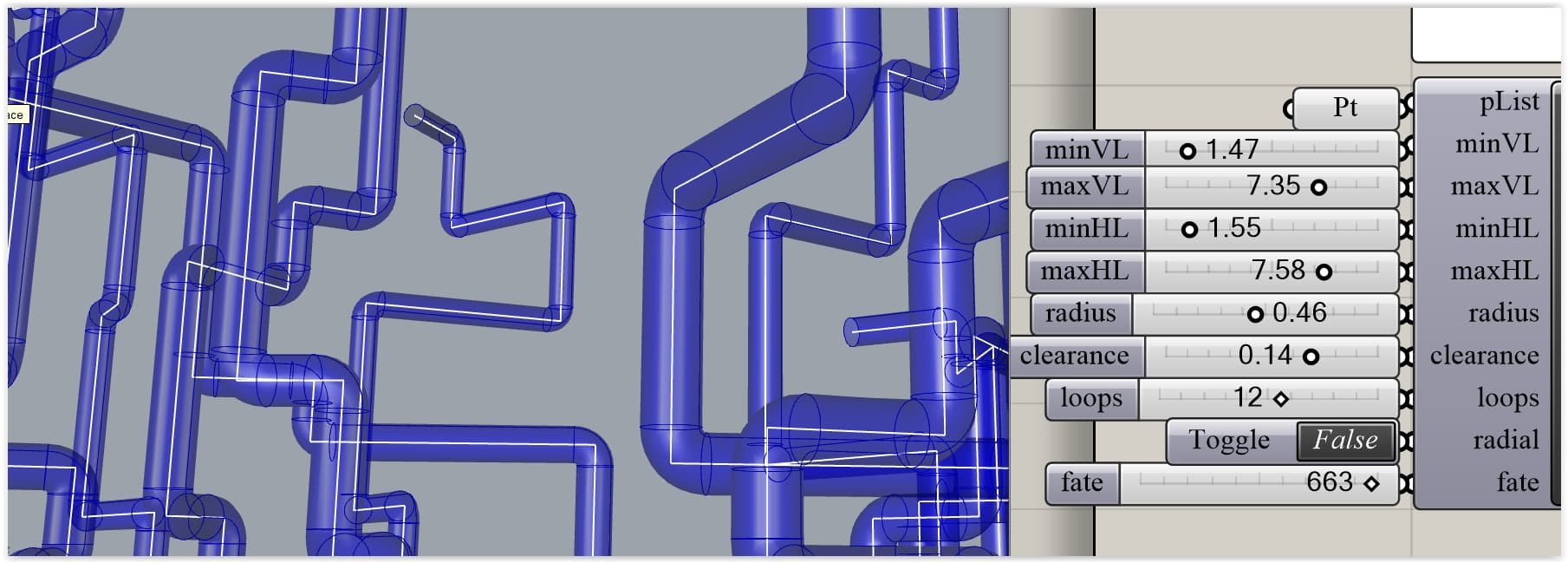

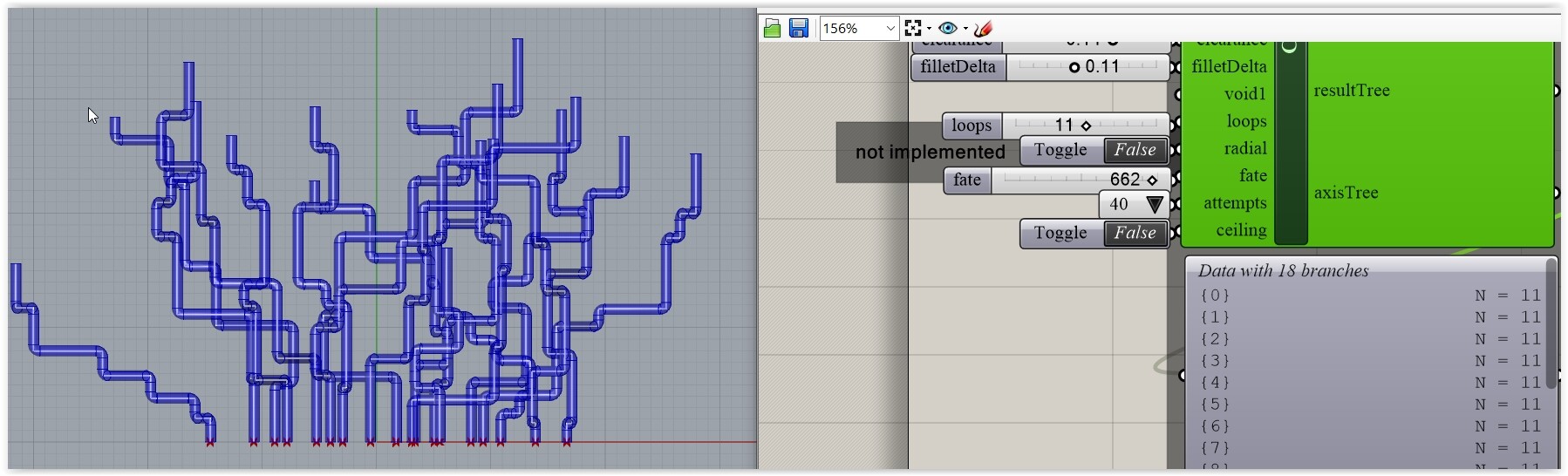

Some Tips (BTW: this is very easy via code)
  1. The tube paths (Lines and Arcs [fillets]) are sampled on a per DataTree basis (of Type Curve) where rhe 1st dim is the index of the base (start) pt.
  2. Two nested Loops are required: the outer [say via i] is from i = 0 to i < loops (see snaps above) and the inner [say via j] is from j = 0 to j < basePts.Count. If i is even (i.e. i%2 == 0) then we move (randomly) up. If not we rotate (randomly)/move(randomly) in a XY plane. For each zigzag pair we create the Fillet as well with R = radius + filletDelta.
  3. Any candidate path segment should been tested (clash) against all the existed (and sampled) segments. That’s done via a classic while(true) Loop where the break happens if the segment is valid (clash free). Obviously more elaborated questions are required: for instance if we go up and there’s a clash against a segment in XY … this means that the path should become locked (unless backtracing is used - but this is a very simple zigzag thingy so why bother?).
  4. A simple crvA.ClosestPoints(crvB, out pA, out pB) check is OK (where pA.DistanceTo(pB) should be greater or equal to: 2 * radius + clearance).
  5. The fillet radius is tube radius + some filletDelta value. Meaning that the min/max amplitudes (vertical/horizontal) require a pre-check as well.
  6. The core Method for all the above:

And that’s the “same” in a 3d grid (also rather very simple [no clash check required] via code and Recursion).
