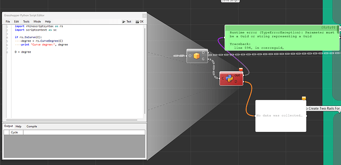

I’m trying to create simple ghpython component that returns the degree number value of the input curve list and stuck on how my input should be hinted/called.
It appears it wants a guid or a string as the input but I want to be able to feed it referenced curves inside GH so I don’t always have guids available for all inputs.
Thanks for your help and pointing me in the right direction!

Hello @michaelvollrath ,
your problem can probably be solved by right-clicking the C input in your python component and setting it’s type hint to Curve.

I did try that without success and then realized I had values in my input list, when I used the clean tree component it now works as expected.
Thanks for your help @lando.schumpich , any tips for the script to ignore null values if I don’t want to add the clean tree component in front of the input?
I thought the first line if statement would handle this (if rs.IsCurve) but I guess not…
I would like to carry the null values onward if possible as sometimes it makes it easier downstream with matching certain data tree operations.
True, the component does not love being fed null data. A simple way to filter null items in python, while still including your condition could look like this:

Thanks Lando, this makes sense. I’ll test and get back to you. Appreciate the help!
Here’s what I ended up with that works:
if C is None:
    D = C
elif rs.IsCurve(C):
    degree = rs.CurveDegree(C)
    print "Curve degree:", degree
    D = degree
