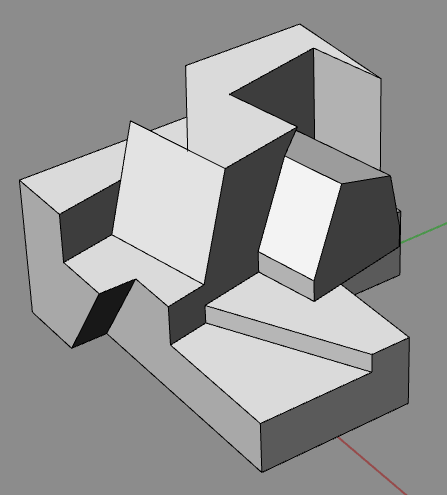

True, it’s like a small script or macro to streamline splitting a face - but once the face is split, it does not actually add the capability that people are asking for for manipulating the split face by pushing/pulling.

I did, and I tried the extrudeSrf command, but it does not work like in the video here
… or the video you posted. I must be stupid. How did you do that?
In both videos the command line is hidden, which makes it hard to tell which command you actually use for the pushy thing.
Please enlighten us!
Use solid tools >> extrude face button ; or you can create new button like this
In the video of the developer maybe he use mouse with many buttons and configure them to use the tool quickly
Thanks, got it! Why ExtrudeSrf did not work simliar to Push/Pull in the first place is because the option “Solid” was not turned on!
That means we actually have this Push/Pull thing already, out of the box! All that fuzz…

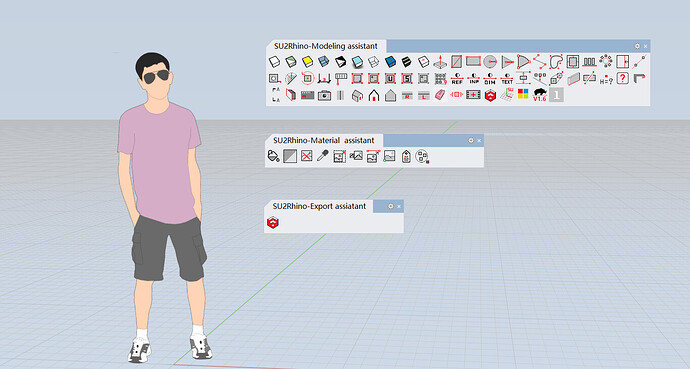

And this but it is not free
https://www.food4rhino.com/app/su2rhino

Works really good! Ootb you can just use SplitFace and ExtrudeSrf -Solid. Goes a long way already.
