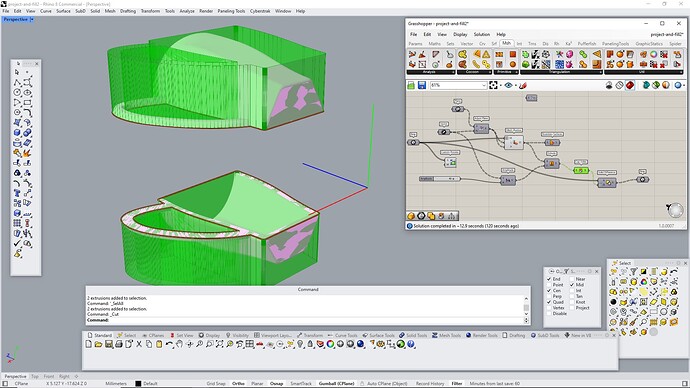

Project to plane, creating solid
I’m working on some mold making and need to project a brep onto a plane, but creating a solid between the brep’s countours and the plane. In something like Solidiworks or Onshape, I would extrude the projection with “up to next” to fill in the space under the brep. But for the life of me I can’t figure it in Grasshopper.
The sample pics and file shows that I may have any number of breps and planes which are not necessarily in the same orientation.
Help please?
project-and-fill.gh (404.1 KB)

project-and-fill_Re.gh (796.4 KB)
I’m not happy at all with this :smiley: it won’t work with any shape that do not have holes lying directly on one of its own bounding_box_faces… but I’m following this conversation because for sure someone will come up with something incredibly smart <3
Thank you! It’s progress, but won’t solve all cases as I add more parts to the mold, and as you say, when holes aren’t parallel to a bounding box face.
My current idea is to create solid extrude of the projection, up past the brep, and then use the brep to cut that extrusion. But it’s not working great because it makes a lot of pieces and it’s hard to determine which ones are on the correct side. This has to be doable, I think?

Here’s what I’m trying for, importing into Onshape and using extrude / up to part:
Shamelessly bumping this post-holiday since I’m still spending hours on this with no luck unless I special case everything for just this one design. I’ve tried approaches using meshes and mesh difference, various solids and boolean operations, extrusions from the projected profile curve… and no luck. Any clever ideas?
tl;dr: I need to project a closed brep onto a plane, creating a single solid closed brep that includes all of the space “inside” the projection.

Ah, but there is Mesh Shadow:
That shadow outline (or a boundary surface from it), extruded up to the brep… that’s my holy grail. Here’s one that has the pieces I need, but thwarted by solid difference (which I know is notoriously finicky):
project-and-fill2.gh (414.5 KB)

I’ve made progress using meshes – here’s an approach that meshes the brep, then deconstructs the mesh and checks each vertex to see if it is occluded “above” by another portion of the mesh. If so, that vertex gets moved to the floor of the mold. Then the mesh is rebuilt.
project-and-fill-mesh.gh (417.9 KB)
Seems pretty good, with a few odd artifacts. But maybe shrinkwrap or mesh smoothing is the next step.
EDIT: argh, the mesh has problems, hidden in the screenshot by having too many components showing preview. Solved with Align Vertices. Seems like the way to do it.
