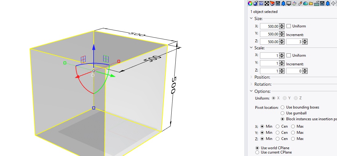

This is my first ever post, so not sure whether I go right about it.I am on Rhino vs 6, latest update.
For the past few days my box edit, Z-values only, do not correspond with actual object size. Scaling is completely out of kilter. I tried to fix problem by re-scaling but nothing worked. Un-installed Rhino Vs 6 3 times now.
Like so many others with seemingly similar problems I use this feature all the time and it must get fixed urgently.

I’m unable to reproduce that here from the information in this post.
In your picture, scale is set to 1,1,1. Is that wrong?
Please try to provide detailed steps to reproduce this issue.
Yes, the Z-scale of 1 setting is most certainly not a true reflection of what the box editor actual does. By the way, it only effects the text. The object itself scales correctly but the text in the size editor is incorrect
Hi Wim
I am hoping the 3 uploaded pics document my problem:
When I draw a cube of 500x500x500 and open box editor the size text reflect the true value.
Picture 2 shows a change in height to 600mm, The Z-scale number changes to 1.2. The cube adjusts correctly when I enter “Apply”, but the Size text changes to 720 and the scale returns to the value of 1.
Kind Regards
Martin
I can duplicate what you are seeing. When you enter apply the cube scales properly and has a height of 600. However the display panel for BoxEdit updates to show what would happen if you scaled again by a factor of 1.2, implying that the object has a dimension of 720, not 600.
@pascal @wim This is either a bug with the display panel updating improperly, or a “feature” based on an assumptions the user would want to scale by the same factor twice. My guess is it is a bug. I wonder if this is the source of several complaints about BoxEdit not working properly in V6.
Hi David - thanks, yeah, it is a bug and has been fixed.
Thanks for the head-up. I was about to down-grade to 6.10 because I wasn’t able to reproduce this here on 6.12.
I’m currently using Version 6 SR11 (6.11.18310.7201, 11/6/2018) and it isn’t fixed in it.
I’ll see if I can find the YT item - I could not reproduce here either, btw, but Mary could.
https://mcneel.myjetbrains.com/youtrack/issue/RH-49211
This problem is a bit different than what is described in that YT item. Could be the same root cause though.
